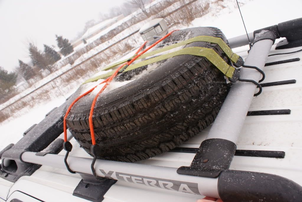

I was concerned about storing my spare tire up on the roof while wheeling for fear of paint damage, until I found this inexpensive (around $16+shipping) yet effective OEM accessory. Haven't seen anyone post up on it, so I thought I'd share my thoughts on the product.

The Application: Four (4) thick rubber strips with adhesive backing designed to run along the raised ribs on the roof, protecting the paint from load scratches and rubs.

Remarks: As you're planning this out, take into consideration where the rack crossbars are positioned. The instructions recommend starting 6.5" from the hatch, but I feel this extends under the back crossbar too far unless you are planning to remove it often. As you can see in the picture below, the rear crossbar is all the way back, and the strips extend past that.
Going back and doing it over again, I would have moved the strips farther forward on the roof to cover the area closer to the gearbox. the Good news is that mine have been on for a year and a half and they haven't budged a bit...great adhesive!

(disclaimer: the bungees were a temporary solution until I secured the wheel properly with straps. Remember to practice safe loading and proper securing methods while operating your own vehicle.)
Cheers!
