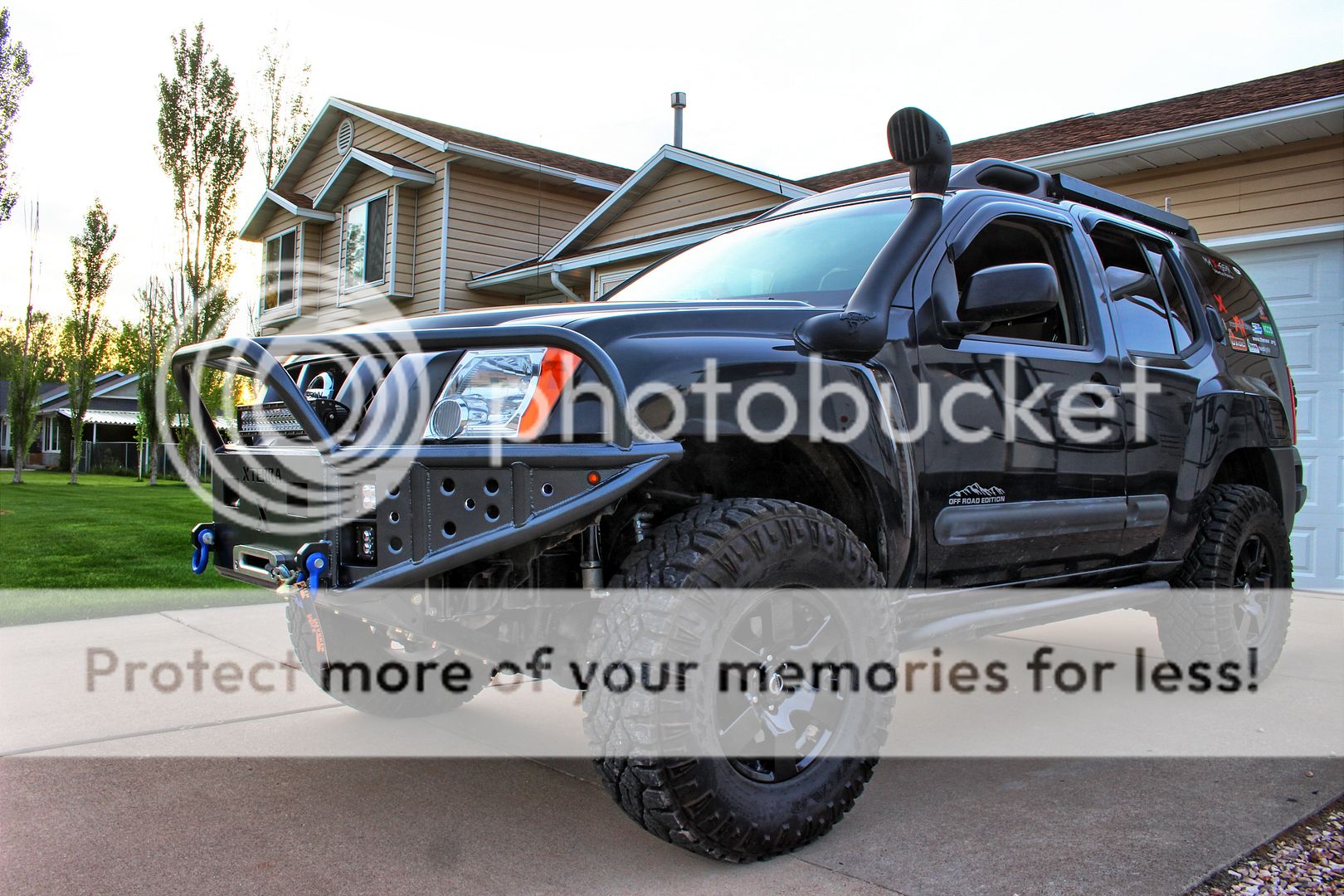

New Front bumper finished
Finally got to finish up the new front bumper for maxterra.
I loved the old one, but soon going with a 2" body lift, 4:56's & 35's.
Didn't want to hack up the old bumper, so it's sold and do myself a new one with adjustable frame mounting.
Went with integral LED lighting this time, and even added LED daytime running lights as is so popular in all the new cars. They're 9w stud mount on the wings in the esmall dimpled holes.
Aurora 2" clear & amber pods on each side and a 20" bar on top (will finish off with a 40" curved roof bar soon).
Turned out pretty nice I think, but a major PITA (again) to build. I first tried running the lower wings up and connecting just before the wrap around bend, but it would have showed and exposed too much stuff behind it, so the tedious task of the bends and slowwww fiitting to get it to all come together.
Filler plates are slow work and a few do-overs with different hole layouts.
Even the little led lamps mounting was slow as I had to make a little fixture thru the hole to mount them all the same alignment plane.
Will have to re-do the lower skid with the body lift, thus it's just painted black for now.
Lotta little things to do before Sunday leaving gore GONE, but getting closer.
Discussion starter · #50 ·
Still need to get a factor55 flatlink hook for the winch line.
Probably time to change the winch line too, as it's been on there at least 4 years, and the hook end has been out in the weather all that time (hence the factor55 end).
Oh, and I added the amber turn indicator LEDs out on the corner again, as I really liked those on the last bumper too.
Now I just need LED headlight conversion to match the rest!!
