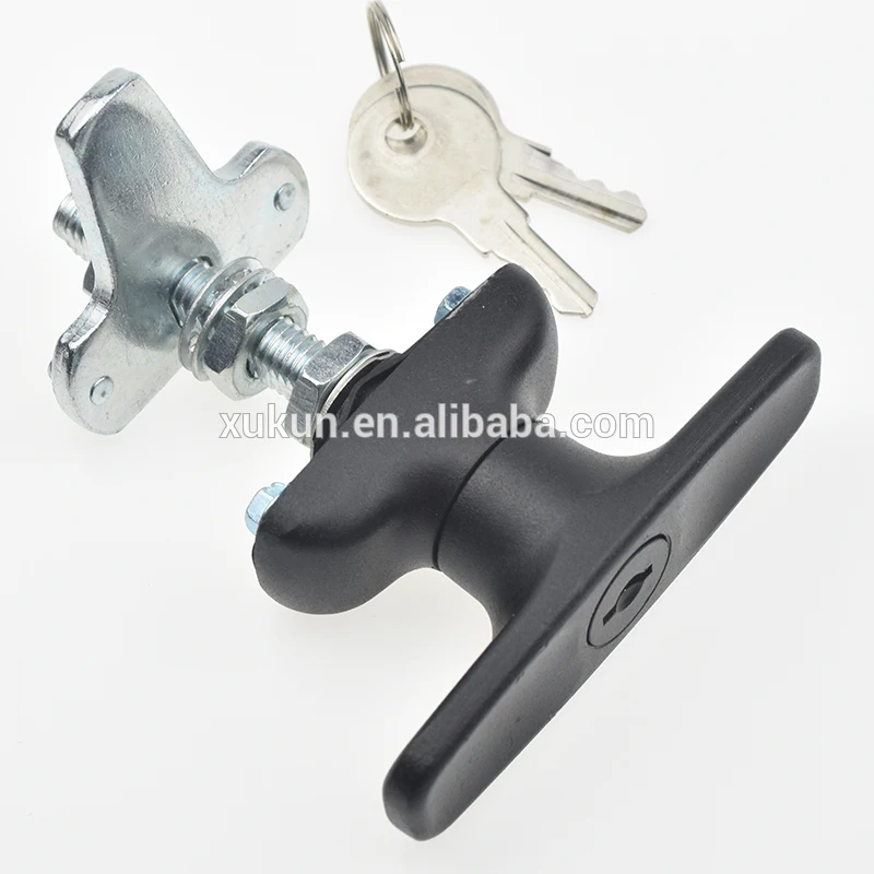

Just as a heads up, if anyone wants to save some money, there is this alternative handle on AliExpress. Listed for $27.50 + $7.07 shipping -- total for me after tax was $36.70. Shipping took about a month. No issues on the install at all other than having to trim the shaft bolt on the handle (2 minutes with the grinder took care of that, and I used the hardware that came with the handle to chase the threads, even though I do have a tap and die kit). Same threads as the original handle -- M10-1.5.
XUKUN Same SOUTHCO 92-21-531 T swivel latch lock black with key mechanical equipment handle cabinet lock
I just installed it and it fit perfectly. This is after searching eBay for the following compatible part numbers, but they were all outrageously priced or not available (Thanks ZheKing for post #90):
