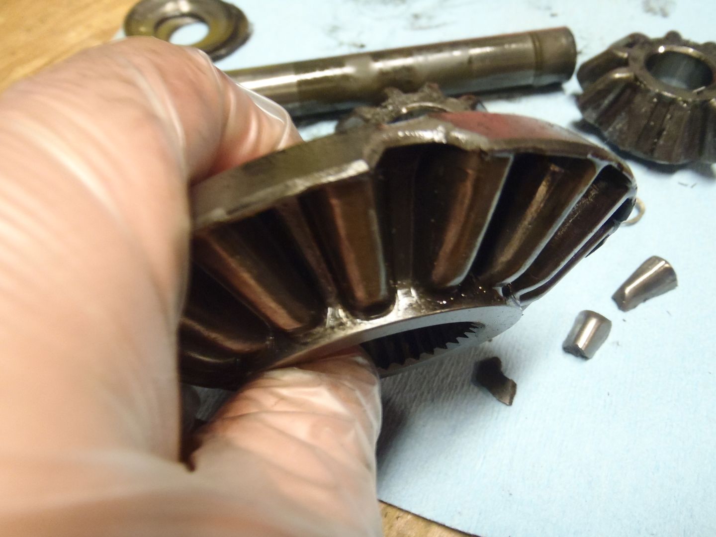

FWIW, I’m one of the guys who grenaded a 2005 2-spider gear e-locker. After that I rebuilt my rear end with an ARB. Much more dependable, and every single piece can be bought and replaced individually if something ever breaks in it.
Grenaded spiders:
