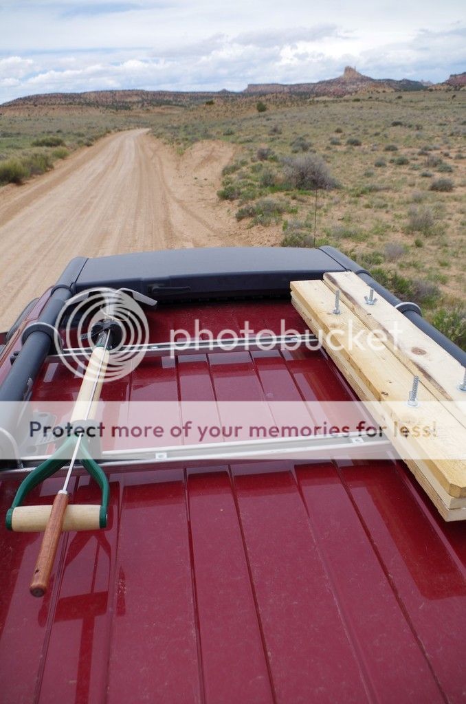

Found another use for the strut crossbars... firewood! And a dirty marshmallow roaster stick.
Pre-drilling/cutting lumber to easily transport it to a camp fire? I guess that IS the safest way lol.
Spread those out a bit, and use them as a "floor" to stack a couple logs parallel to the strut, then run a tie-strap around the strut to lock it all down.

Haha yeah! It is a little odd, but... it's free from my work, it's already cut in the right size pieces and it's clean, dry wood. I just have to drill a couple holes, so it takes seconds with a drill press and wood bit.
I could also use it as a platform to carry odd sized items. Or under the wheels to get unstuck, or probably lots of other uses.

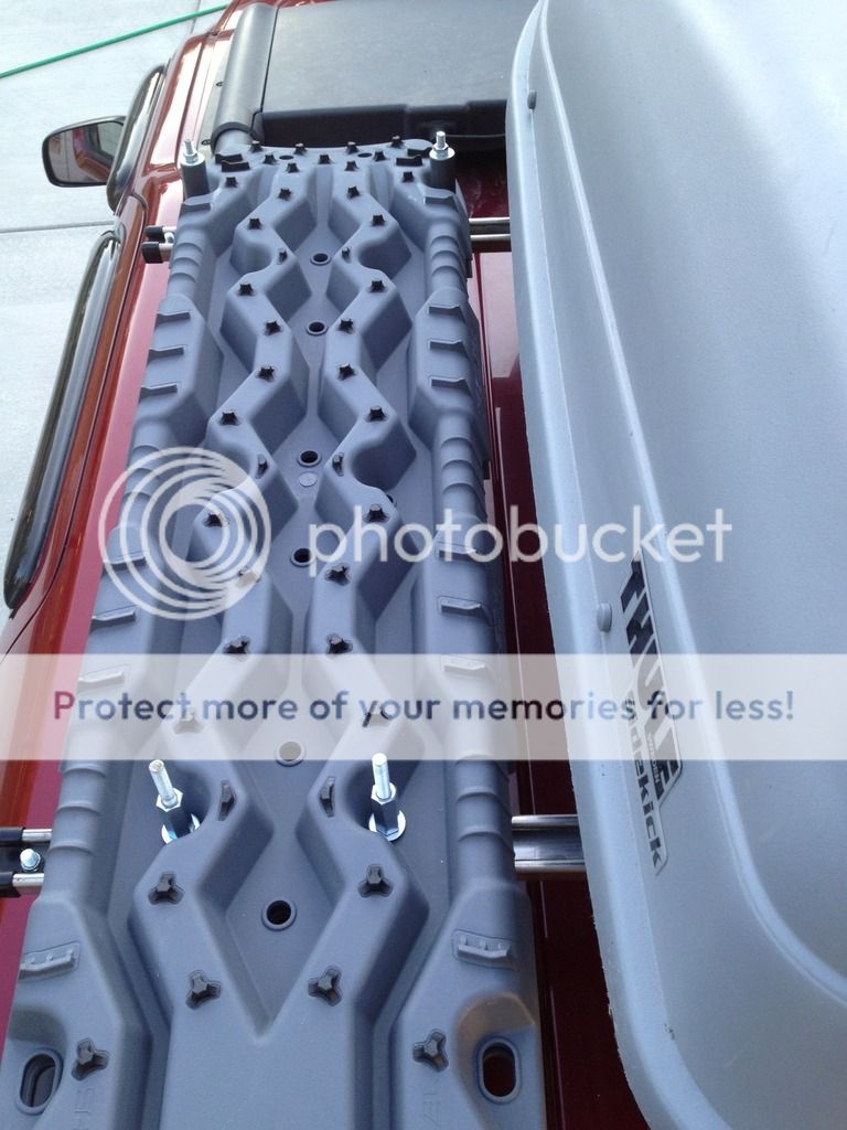

Two months after I posted that, my Tred Pro's finally arrived. I had been hoping that with all the potential mounting holes, somehow they would line up the same as the Rotopax. Unfortunately they're just a bit off, bummer. I may go with the third crossbar when I'm carrying Treds plus fuel.
We are heading up to Wyoming this weekend for a camping trip. I don't think we'll need extra fuel but did want extra storage up top, so I inverted the strut mounts to give a little more width for the pair of Treds and our little Thule cargo box. Still need to figure out a solution for mounting my shovel on top of the Treds.

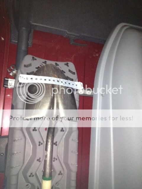

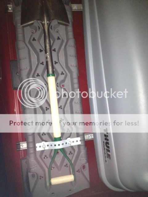

Figured I should update this, the shovel mount was incredibly simple. Just added some thick steel strap with holes and wing nuts to secure it to the Tred Pro mount.
Sorry for the low quality pics but it should be pretty easy to see how it works. Didn't budge on a 2000 mile road trip.
Maybe some rubbler/foam so it doesn't wiggle loose and develop a rattle? I'm thinking metal stretching, bending, treds compressing a bit, etc... something that would leave to wiggle, which would lead to wear.
It DOES look simple and effective though!
I know the treds are supposed to be "used as a shovel".... but I can't see that working well AT ALL for anything except the softest of sand.... so thats a nice convenient way to get the shovel and treds all at the same time.

I thought it may loosen up too, but on this trip it did not. I have some inner tube rubber that I carry in the tool kit for things like that, but didn't need it at all. Conveniently, this particular shovel nestles nicely in the pattern of the Treds, like it was made to fit there.
Yes the Treds would suck to use as a shovel. Better than your hands I guess. I also carry a packable snow shovel that would be better in loose sand and, well, snow... it fits in the rooftop cargo bin.

A lot of times I don't need to bring extra fuel, or just need the 2GL in the wet box for a little fuel insurance, but the crossbars continue to be really handy for carrying the Tred's and a shovel. Finally got around to taking a couple better photos of that setup.
I used the quickfists for an easy place to stash my roof mounted NMO mount CB antenna when going through some low hanging branches. Took just a moment to unscrew the antenna, clamp the base in the quickfist, then drive through the branches without ripping anything off. Worked great.
I have thought about getting some star knobs rather than the simple little wing nuts, but it seems like that would draw more attention to what's up there, so for now they're doing the job. I have not had any significant loosening up with this setup on many weekend trips to the desert, and week long road trips over several states.
