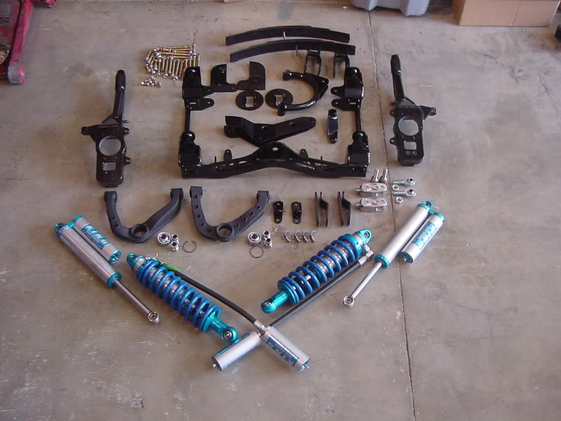

Yep, SLR 5 inch kit, exactly as pictured here:
That is bad ass and I felt lucky to have one of these unicorns. I spent a few hours reading various forums and got a quick education on the issues of SLR, from mishandling of customer orders and demise of SLR as a company. Really unfortunate as these kits are amazing and seem to be head and shoulders above the other drop bracket kits out there.
