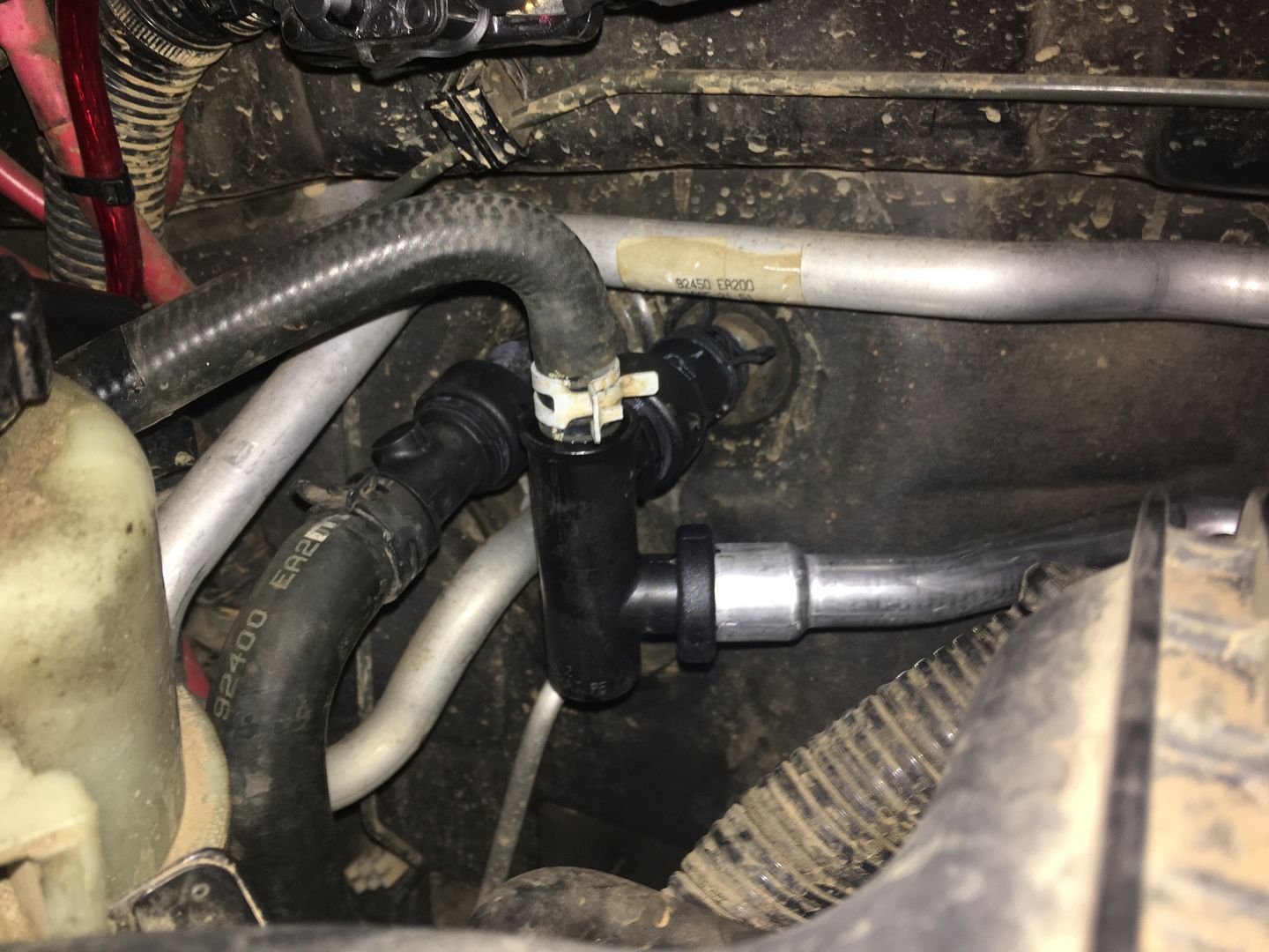

Don't know if this has already been mentioned, but I was getting ready to order the OEM part, and found what looks to be a better aftermarket version for less. Aluminum instead of OEM plastic. Looks like it even comes with a nifty clamp holding tool for easy install.
For those that don't know, this is one of the hose/adapter assemblies coming from the heater core connection on the passenger side, engine bay firewall. If you have an older X, this is one of those plastic coolant parts that gets brittle and should be replaced for a peace of mind.

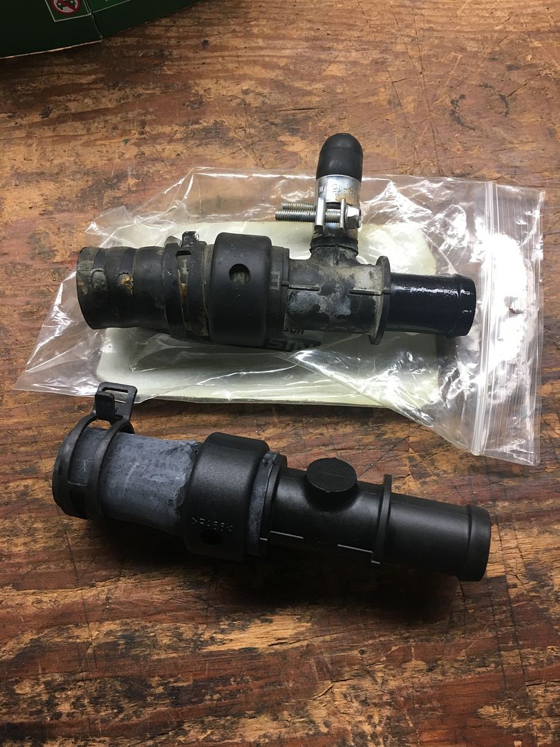

Yeah man save yourself the surprise I went through haha. I stopped at a red light on a paved road and steam started coming out everywhere I thought the thing had caught on fire at first.
When I pulled over and took a look at it the inlet part had sheared off on both ends. The new one is designed a little differently without the nipple part. Here's a pic:
Do the heater hoses. The plastic gets brittle and breaks.

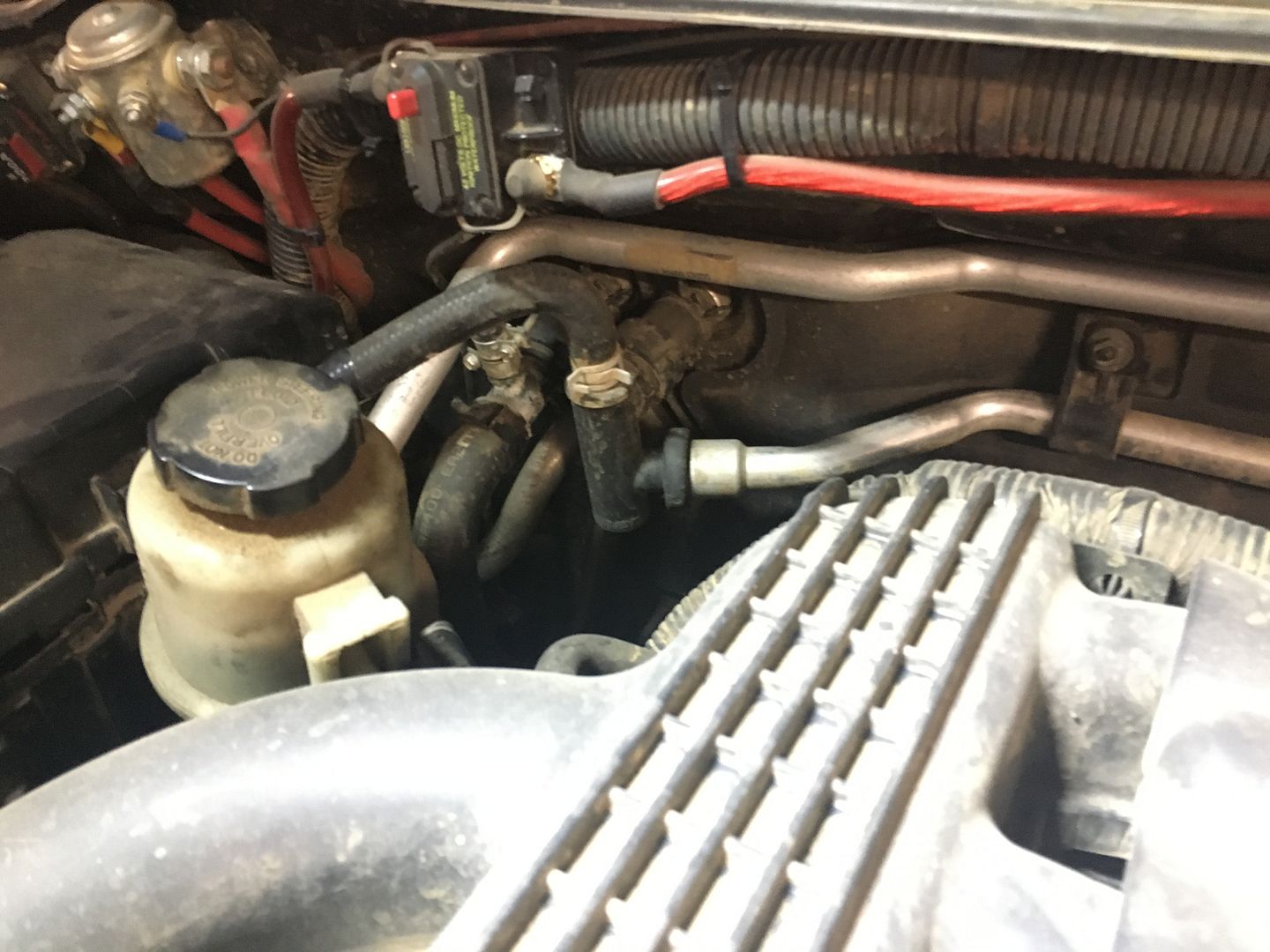

I replaced the heater hose assembles for preventative maintenance.
Old:
New:
