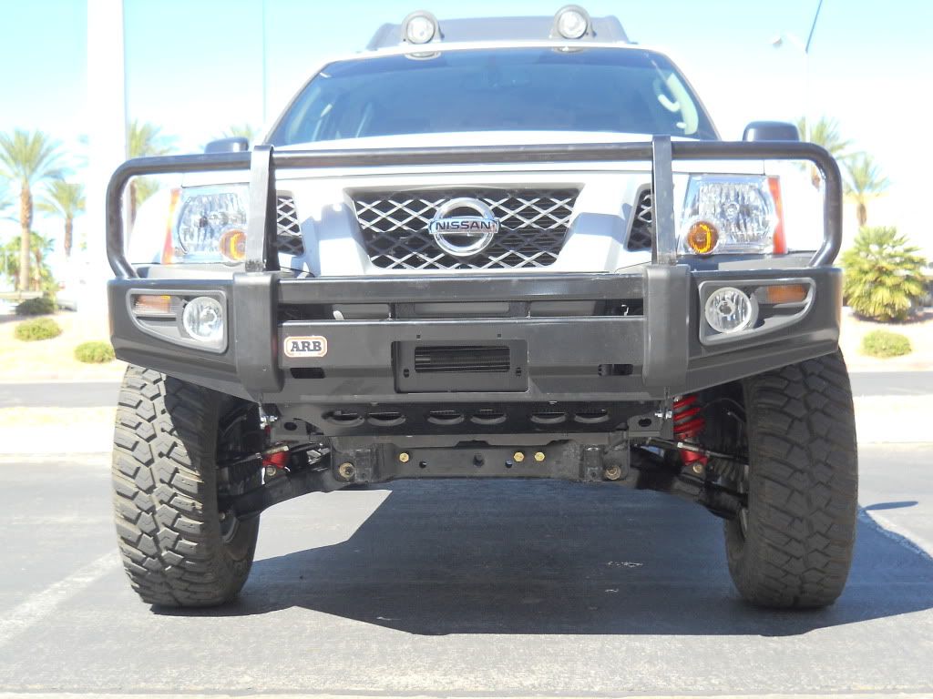

ARB front bumper
AJ Superquare Sliders
Shrock radiator skid

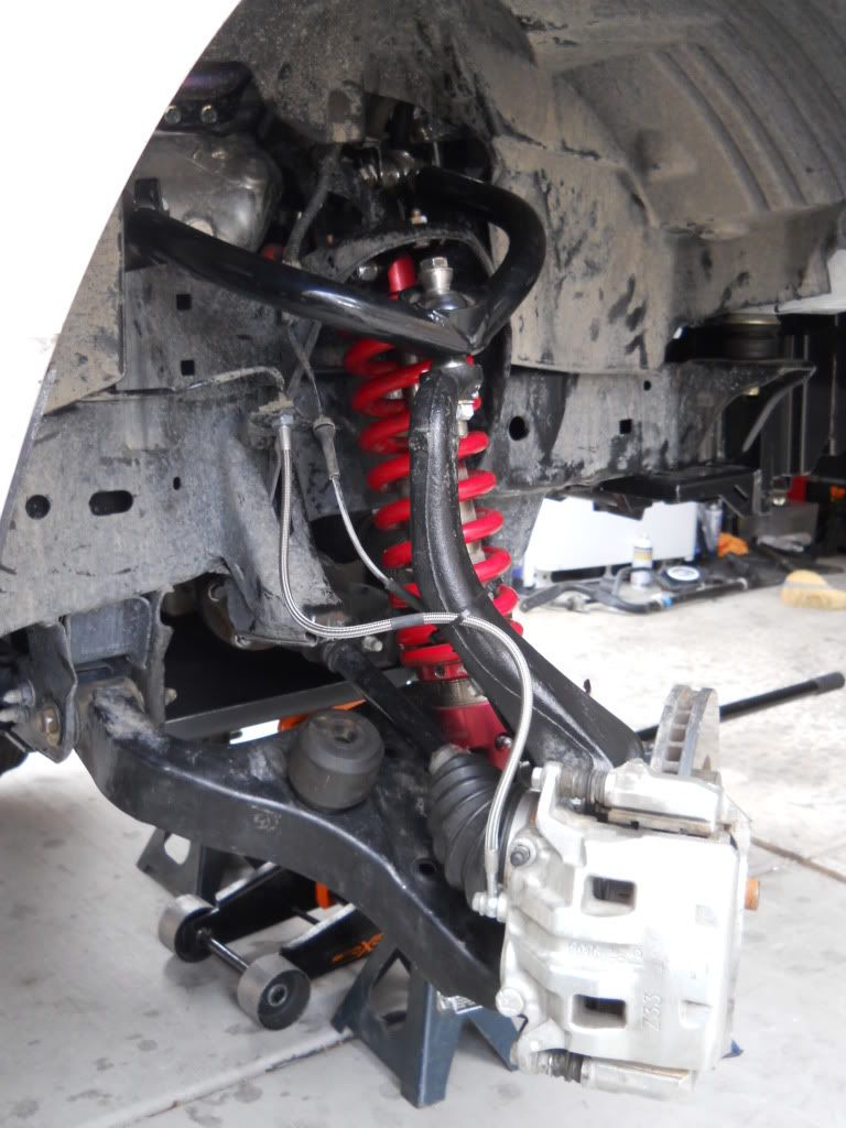

PRG SAW Titan Swap kit
* 2.5" Sway-A-Away Coilovers with remote resivoirs w/ Eibach Springs (13"x650lbs.)
* Titan LCA (stock)
* Titan PRG adjustable UCA (rebuilt 07/28/2011)
* PRG tie-rod extensions
Titan M205 Front Axle (Pre-06' model)
Titan CV Axles (Rock Auto)
Timbren front bumpstops

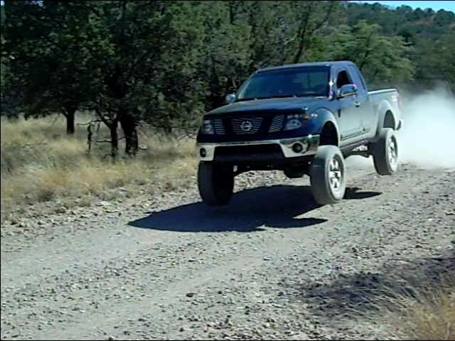

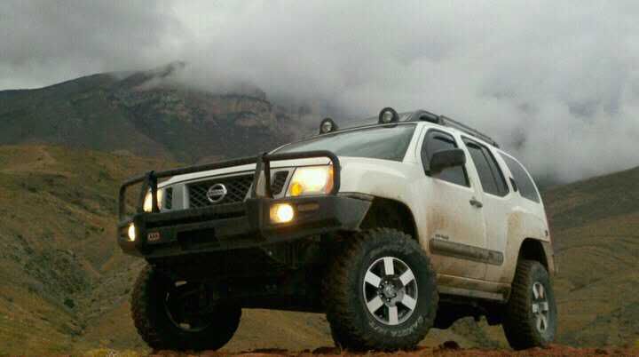

Comments: This truck did not stay stock for long. I owned a 2006 Nissan frontier 2wd with the nismo package (pictured below) that I heavily modified over time. I beleive my truck was the first truck to use Sway-a-ways on a titan swap. I eventually grew tired of having a 2wd and no real back seats. The Xterra made sense. From there I adapted as much as I could off of the frontier onto the xterra resulting in the Beast of a 2010 you'll see below.
This is how it all started... 2006 Nissan Frontier 2wd Nismo Pkg
Old truck in its prime:
ARB front bumper added
Titan Swap Added
Moab HighLights 05/2011

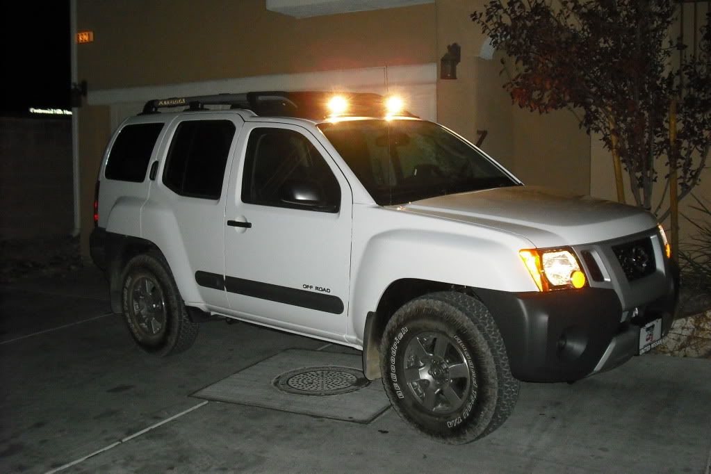

no its just night time pics.... they're silver/chrome actually. Suprised the base models get them and not the OR. who likes chrome anymore? Getting blacked out lights is defitnly going to be one of the first things i do. Nice to know this time i around I dont have to buy an extra set and still bake and paint them, just gotta buy the black ones.
I wonder if nissan noticed how many people did the blacked out light mod and applied it as a oem piece?

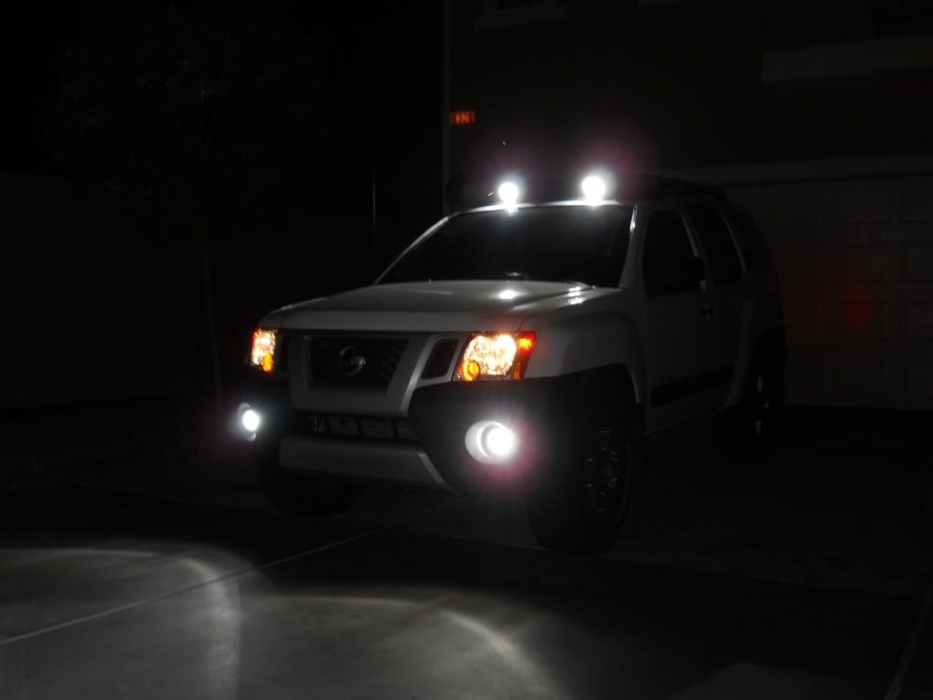

Ya know.... the lights are small but they actually do their job at night while offroading. I thought about selling them and replacing them with a fangers rack but, waste of money when i have perfectly good lights now.

So as far as the titan swap goes, this is my list of parts:
I have:
Titan LCA's (need to cut sway bar mounts off)
PRG heim UCA's
SAW 2.5" coilover (needs to be revalved for a 4x4 X)
Tierod ext.'s
Stillen drilled rotors
PRG shackle
Fox Bumpstops (doubt I'll use them for this truck but we'll see)
I need:
Ext. R180 Axles or M205 with Titan Axles
AAL 2"
Longer rear shocks (undecided on brand but leaning towards emulsion radflos)
Front and rear ext. brake lines
Beefy Tires of some sort or might just rock the Rugged trails till they die
It adds up quick, looking at around $1200 + SAW rebuild and tires. Havent even made my first payment, hahaha

Not to take away from your nice new ride, but I'm diggin' the action shot of your old truck in the first pic. How did you like the bumpstops? I've been looking at the different ones between Fox, Light Racing, Ballistic, and the cheaper Daystar Stingers. Just don't know that I could justify the cost over a set of Timbrens.
