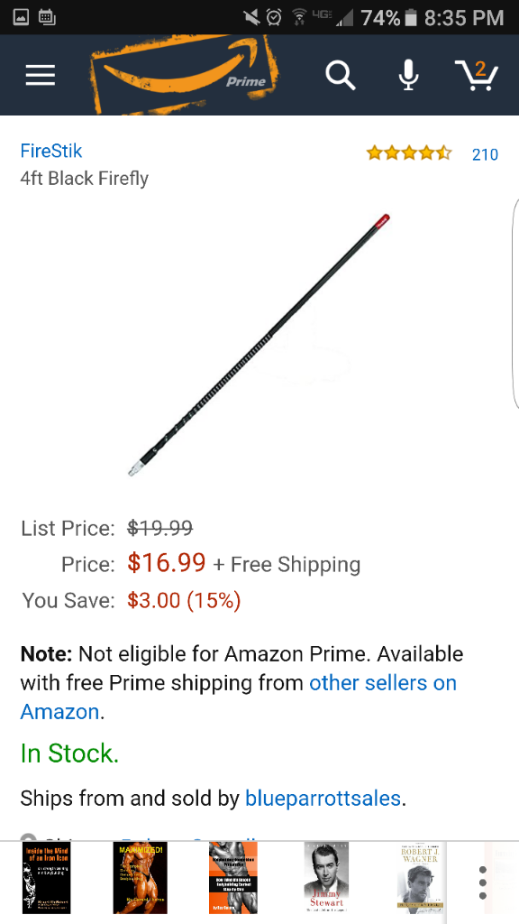

FireStik 5ft vs Firefly 4ft Antenna
10K views 7 replies 4 participants last post by  Mr. Bills

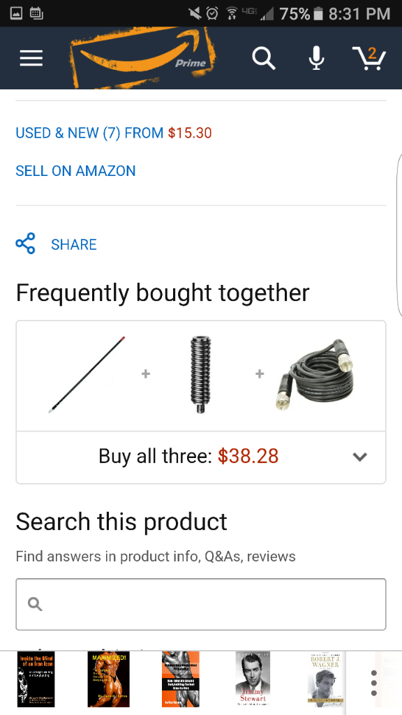

I use a Firestik Firefly antenna with Firestik medium spring. I have not found it to be any less durable than the regular Firestik antenna.
