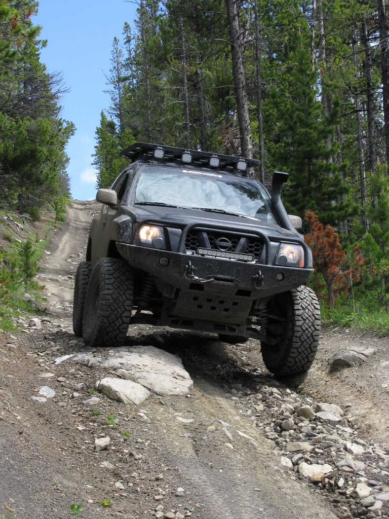

AS IT SITS TODAY

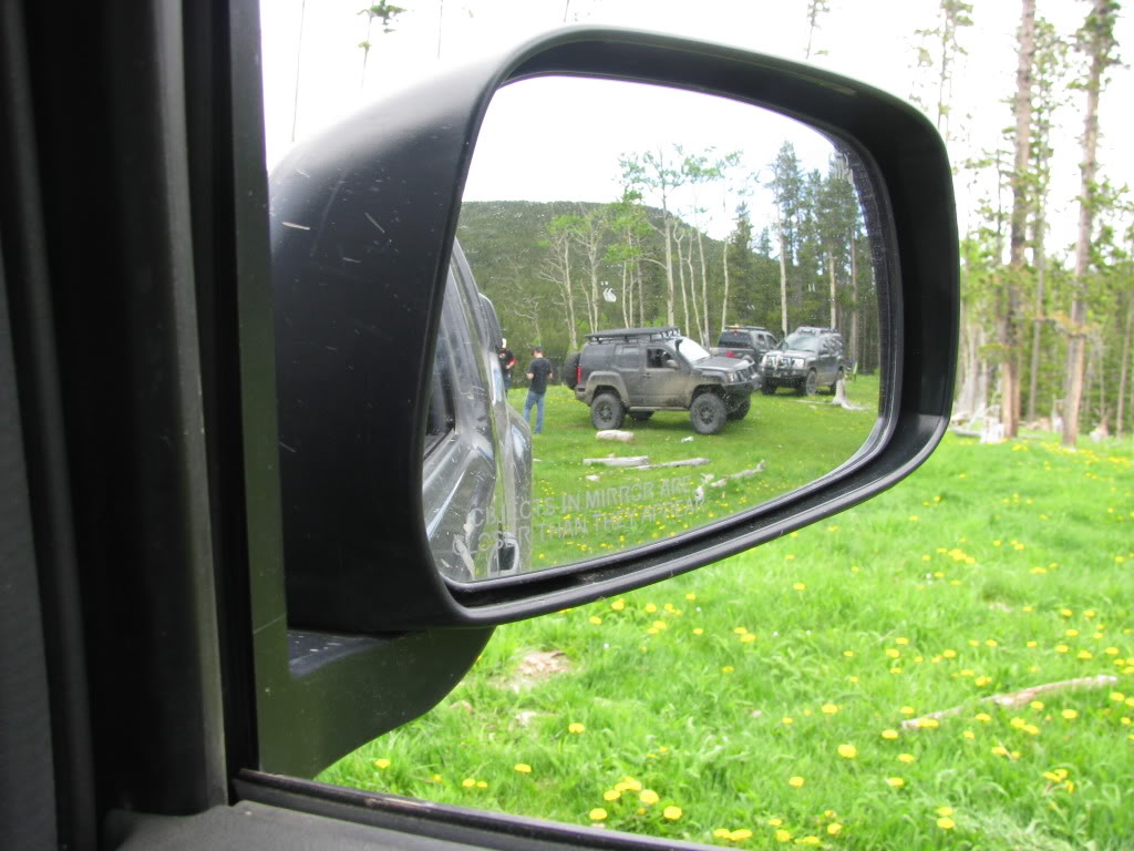

• blindspot mirror mod *. little adjustable round mirrors.

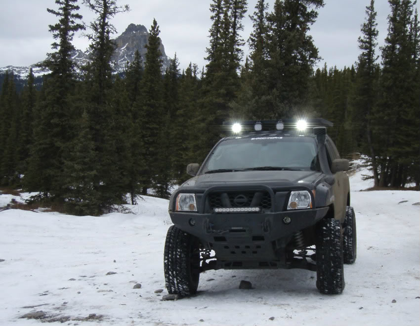

• VISION X Evo 1220 l.e.d. light bar ****. (national4wd.com)
• VISION X l.e.d. roof lights x 4 (2 x 40 degrees , and 2 x 10 degrees ***). (national4wd.com)
• oem fog lights w/ Hella 65 watt yellow bulbs in shrockworks bumper **.
• VISION X solstice l.e.d. REAR ROOF RACK LIGHTS x 2 ***. (national4wd.com)

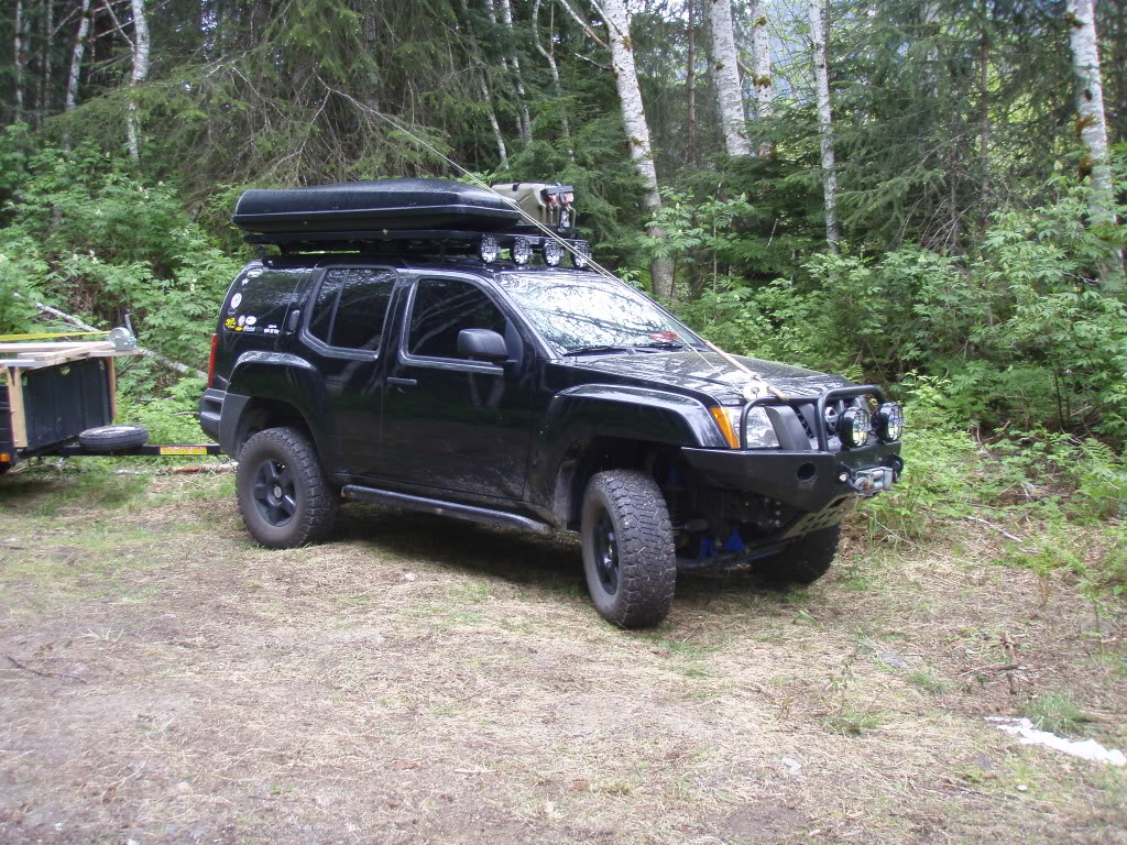

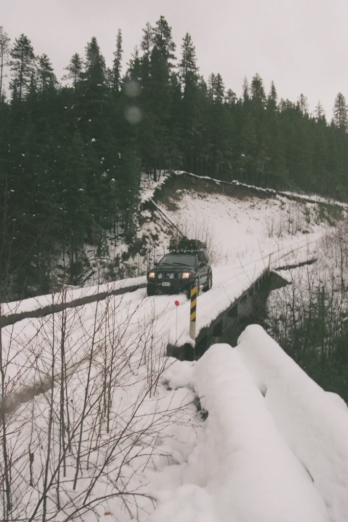

NEARLY NEW!!! STOCK HEIGHT, WAITING FOR LIFT TO BE DESIGNED/FABBED, 285/75/16'S (33's), SHROCKED OUT, HANNIBALED, GIBSON CAT BACK EXHAUST, PIA LIGHTS, HANNIBAL ROOF RACK, AND VOLANT CAI.

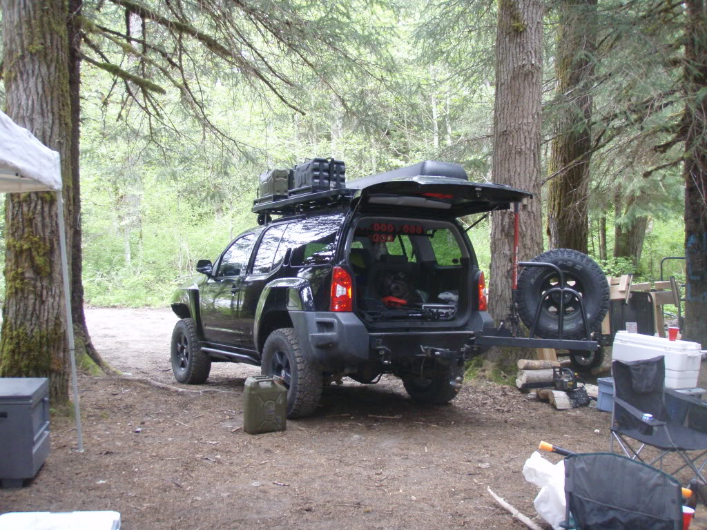

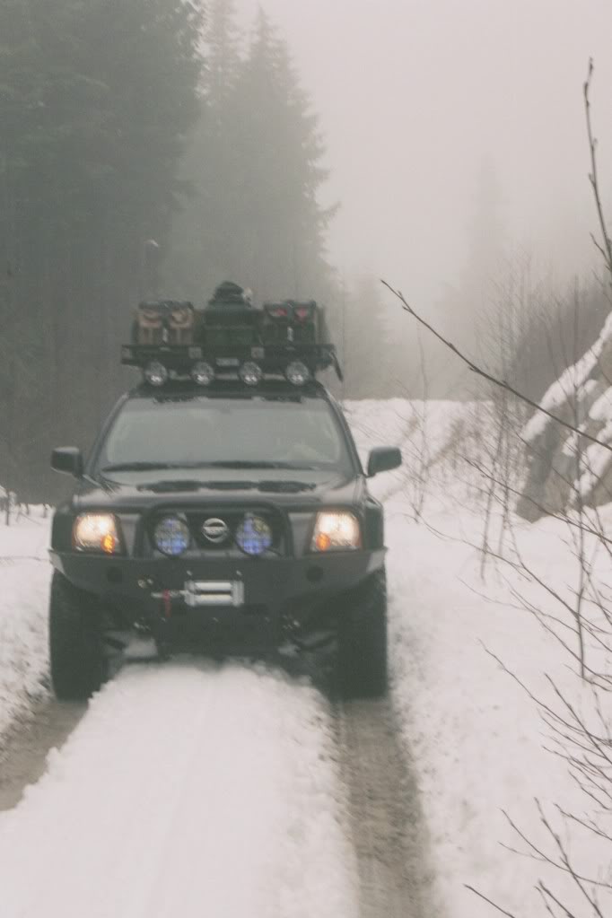

AFTER CALMINI 5" LIFT.

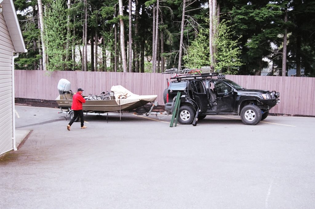

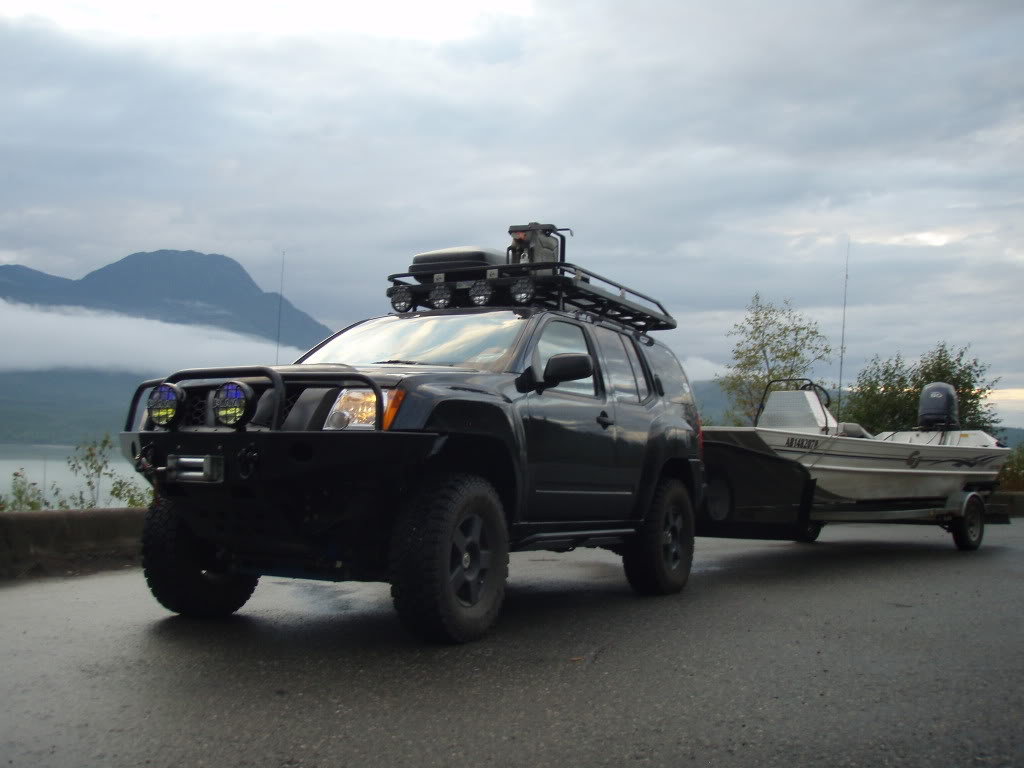

THE CONTINUOUS PITA PROBLEM OF GEAR AND TOUNGUE WEIGHT ISSUES WHEN TOWING, SOLVED WITH HELLWIG HELPER SPRINGS (retired), now running AIRLIFT AIR HELPER SPRINGS.

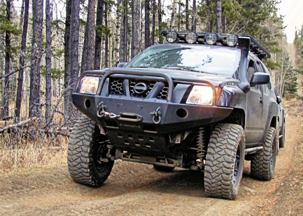

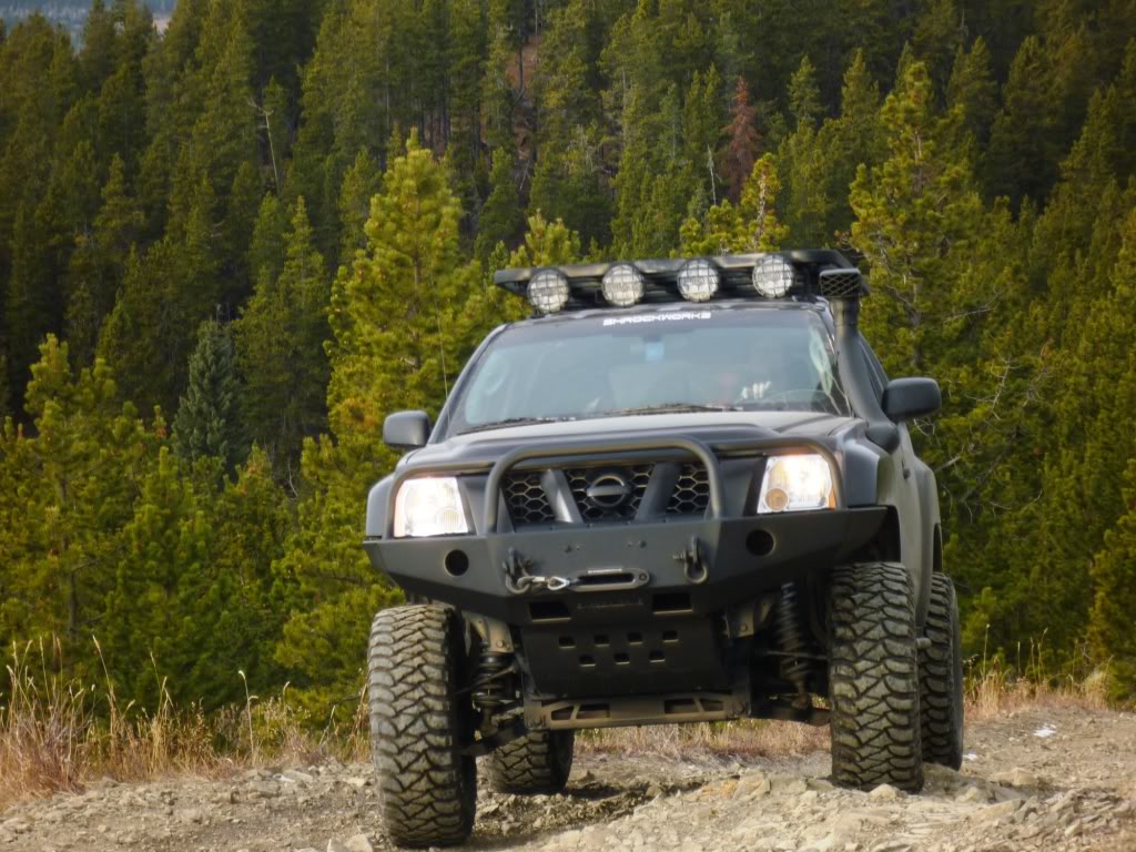

(october 2011): radflo 2.5" coilovers, and prg uca's, before titan swap.
