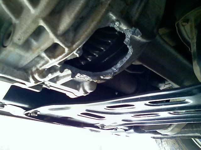

I am new to wheeling, and have little to no experience doing it, and I decided to go wheeling somewhere I probaly shouldnt have been. Well I went alone and wound up getting stuck at the bottom of a hill and could not get back up, and wound up blowing out...

Clearly he is a kid who made some mistakes.....And them some. But you should be able to THRASH your truck with stock tires, gearing, ect without stuff exploding. You should not have to walk on egg shells and drive gental to avoid breakage. Having the differential housing blow apart is unheard of. After 20 years of wheeling I have seen even Dana 35 stock Jeeps pound the throttle on a ledge for a rediculous amount of time, and not even break an axle. And have witnessed 100s of Monteros over the years do crazy things.
I try to be gental on my 250,000 mile stock drivetrane Montero because of 35s and age, and hating to break. Same for the Xterra because it was brand new. But sometimes you have to get on it off-road, thats just the way it is. That is also why we don't have a Maxima drivetrane.
Youll also notice, most of these breaks occur the first time off-road...second time...6th time for me. Not like we are tallking long term abuse.

The weight difference is negligable. My LE CC 4x4 is actually heavier than an X. I think the only reason that the X's are breaking more is that more people wheel their X than wheel their fronty. The housing is not the issue. It is only coming apart when the ring and pinion pick up the broken pieces and spread the housing. I have seen multiple references to the housing being weak because it is aluminum, but the 03 04 Cobra's have aluminum housings and they only explode at 400+ WHP and slicks unless they are abused constantly.
735 Posts
I think the concensus is that the front diff is too small for a 4400 lb 4x4 with a decent amount of power.
the rear can have a new carrier put in, an 8.5 inch gear is fine for a 6 cyl truck-so that isn't a deal breaker, but the front will not work hard. My gut feeling is that the cast aluminum housing will flex a bit in a weak area over cast iron, but fullsize trucks run aluminum diffs with not nearly as much trouble as this application- I think it needs to be a 200 mm or bigger piece.
so you know what you have. Relegate your X to light wheeling, grocery getting, snow driving or go to something completely custom (expensive). Perhaps in the next couple of years nissan will come out with a stout front drive that will adapt to the short control arms scheme that the fronty/Xterra uses. Basically Nissan could come up with an oem solution-a short axle that will fit the titan diff, then we would be saved.

for me breaking parts isn't my biggest concern. i know tolerances stack up, parts vary and assemblies vary more, design/GD&T/QC inspection can only do so much and there is a huge dynamic when varied terrain and a full range of operator skill is also thrown into the mix. the biggest problem i see, and what makes me the most nervous, is rolling the warranty dice and hoping nissan will stand behind their vehicles and support current owners. from the reports on this and a few other boards it seems like you really do roll the dice w/the dealer and then nissan as well. this is particularly disheartening when the closest dealer only hires circus clowns and living brain donors.

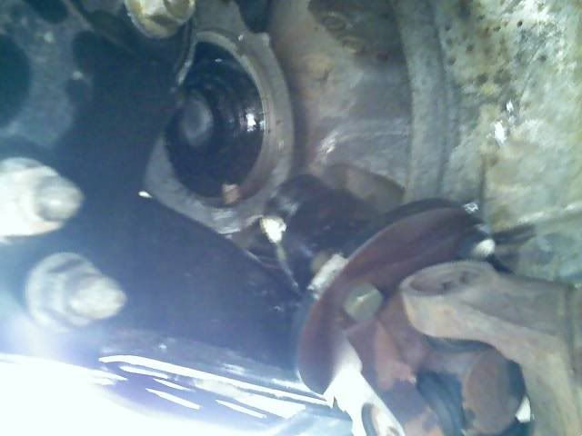

OK, so the guy was a n00b at offroading, we all were at one point right? But the diff still shouldn't have gone south. Yes we all know you pay to play the game, inherited part of the sport. But I would assume that lesser parts go first. I could see trashing a CV, destroying a u-joint, burning a clutch, you know...something that is a known weak link in all vehicles. But a differential?
To me, it looks like the pinion sheared, snapped, whatever...it got FUBAR'ed. If it did shear, why? Or rather, how? Maybe the spider gears went, lodges the ring, the pinion still tried to spin but he ring wouldn't budge, so the torque took it apart. Then comes the havoc to the case from all the external failures. I think the u-joint should have went waaaay ahead. Of course this is all pure speculation on my part.
And the comments about these rigs not being offroad worthy, thats a cop out. If thats the case than Nissan needs to remove the NISMO Off Road sticker from the Frontier and the Off Road badging from the Xterra. Then they need to rethink their entire marketing campaign for the trucks. The brochures need to be redone with out all the offroading in it. Same goes for the website, its all about offroad glory...they should show the vehicle hauling a bunch of groceries and offroad on the front lawn. They offer two vehicles with a package that includes "skid plates", a locker, pseudo-aggressive tires, better shocks, and cool badging. Nissan knew people were going to take these rigs offroading, especially since the web forums/clubs are hard to miss. ::sigh:: I feel like I've made this argument before.
Nissan knows whats going on but trying to ignore it. You can only sweep so much debris (in this case, differentials) under the carpet before everyone notices it. Don't get me wrong though, I love my truck and wouldn't trade it in tomorrow for any other comparibly priced 4wd. Do I keep breaking a diff in my mind all the time? Nah, but it does make me think twice before I mash the gas in 4wd. I really don't see me breaking an axle in the foreseeable future, for the only time I have a heavy foot is when I'm on solid ground and in 2wd. Now if I break an axle while in 2wd on the road.....we'll have a whole new set of worries.

They aren't worthy..the front diffs are going out on loose terrain..the rest of the truck is fine, but what can you do? Wait for nissan to update on future models (maybe never). trade or sell and buy into a more rugged vehicle next time around, or just don't put bigger tires, accessory weight, or a lot of throttle on it when in 4x4 low range.
Nissan might cover you once if you have stock tires. I don't see nissan doing buybacks though. Either sell the beast, SAS it on your own dime or whatever. I see mine for what it is..a versatile foul weather buggy and grocery getter. I'd like to think it was as rugged as marketing suggested, but I primarily bought it because it had 4 doors and a kick ass v6. I also used to have a semi-built tj so I didn't expect it to be the choice for rocky trail running. I think if they adapt the titan front diff into it, the problem would be solved, but i think they were trying to squeeze the gas mileage out of the truck by making the running gear have less rolling mass.
