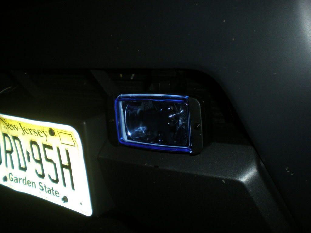

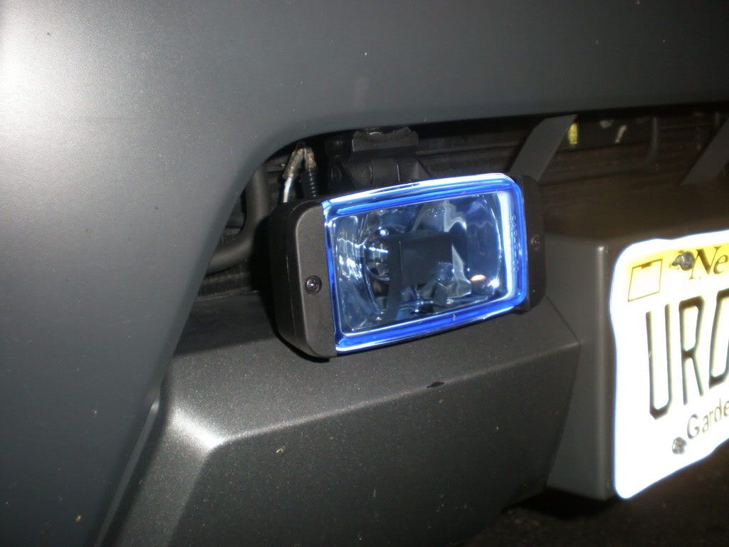

i mounted them right above my lisence plate

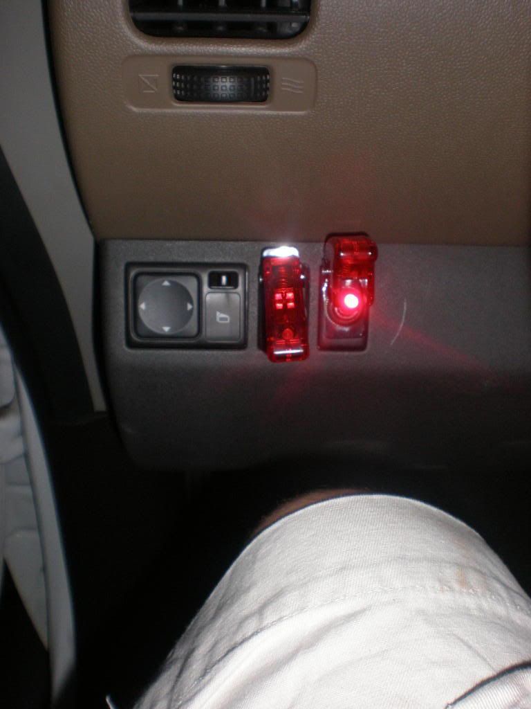

I got these cool airline switches at radio shack for 3 bucks with a led on it its pretty sick. only one is hooked up because i didnt get my hella 500's yet

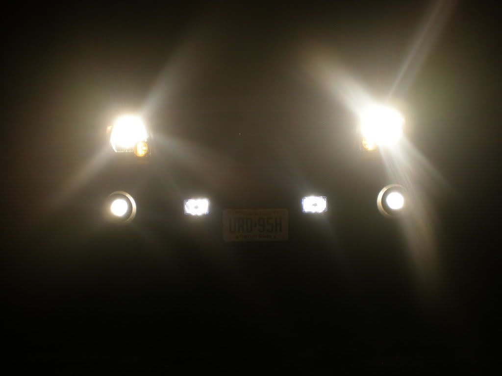

and the finished product they are only 55 watt but they still light up the road pretty well
