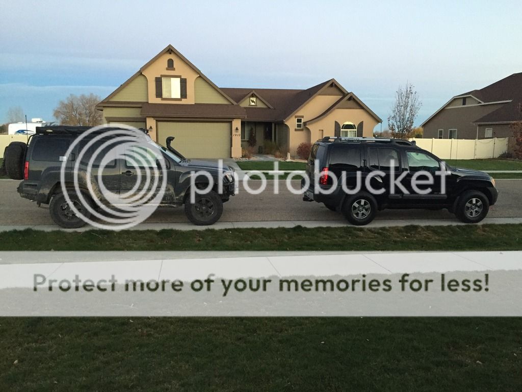

Only took a few hours to do but got the spacers in, gained 3/4 of an inch on each side.
I feel like the driving position is more comfortable now. Could just be me thinking it is...
before
after
