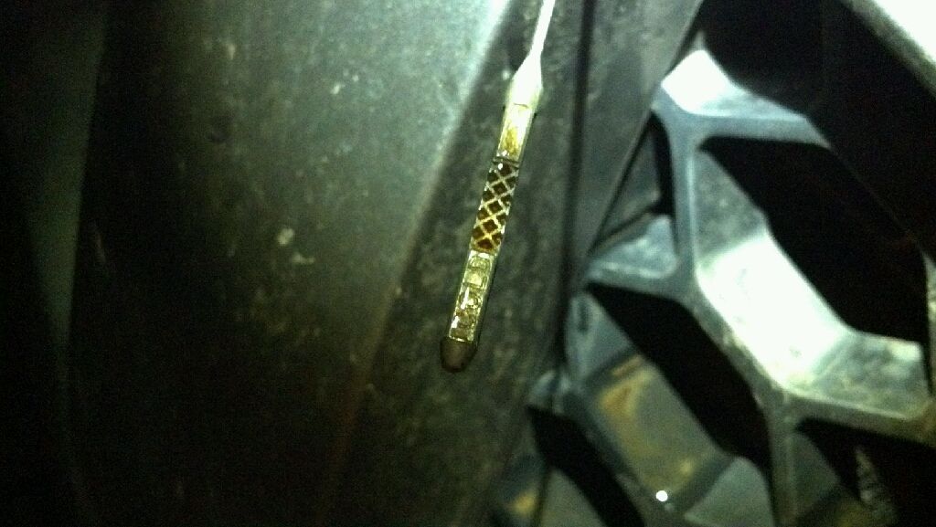

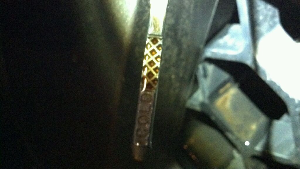

Hey all, have an '06 SE (possibly) with auto tranny. I've been reading a lot on the SMOD stuff and decided I'd better check on it. I went out and here is what is on the tranny stick:
Forgive the terrible pics and my lack of automatic transmission knowledge, this is my first ever auto tranny. Color doesn't seem to be SMOD, but it also doesn't look clean, best described as a translucent golden brown. I've owned this since 64,418 miles and it is on 73,XXX currently ... looks like it needs changed ...

Yup, time to flush. Pretty easy DIY job, lots of info on how to on this forum.
2,931 Posts
With that color I would do a drain/fill/drive three times. Thats what it took on mine to go from the color you have to a nice clean red color like its supposed to be. Its a lot cheaper to do if you order the stuff online as well.
1,054 Posts
With a full flush, no need to drain/drive/refill three times.
Also, depending on how comfortable you are with doing so, might not be a bad idea to go ahead and drop the pan, check the magnets, replace the filter. This is a much more involved process than the simple flush but still not overly difficult. Plenty of info on this forum on how to do everything.
Cheers!
2,224 Posts
It is a red color, but mine is basically clear on the dip stick. I just do a quick drain refill every 15-20K miles or so. If I had brown fluid on the dip stick I would do a PMF.
32 Posts
Discussion Starter · #8 ·
Well, thanks for the info guys. Looks like I'll be doing the PMF, (although at $114 for 12 quarts of ATF it can hardly be considered 'poor mans'). I might try and sneak under the X this weekend and do the bypass to get that out of the way.
It's cold as hell here in the PNW right now so no worries about overheating the tranny until summertime rolls around and then I'll add a cooler.
I might take H.I.'s suggestion and drop the pan real quick to.
