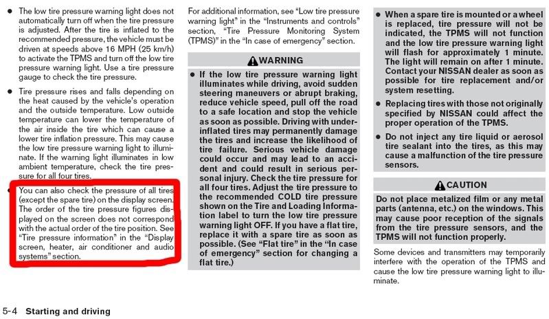

Am I missing something in the manual? I read the following about TPMS (Tire Pressure Monitoring System) which says that I can view the actual pressure on the display screen. I have gone back and forth in the manual but I don't see where it shows you how to check it. Am I just reading it wrong? Please clue me in.
I have a feeling that is a bleed over in the Owners Manual from a more upscale model Nissan (Z, Pathfinder, etc).

Huh, my S doesn't have that function, so I thought the SE had it. But Muzikman is probably right, in that Cut $ Paste makes this kind of editing error too easy to make.

If any would have it, it would be the SE as it's got the computer where the odometer is. But I have never heard of the SE even having this function.
