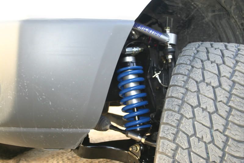

Today I finally installed my Titan suspension on my XE Frontier, 2.5 Radflo's w/ resi, Total Chaos Titan upper control arms, stock Titan lowers, PRG steering extensions. Here's some pics:

Titan Total Chaos upper arms, stock Titan lower arms, coilovers ( your choice) steering extensions/ or heim steering. You can put Titan stuff on 4wd's with custom axles ( I'm pretty sure, might have to move the lower shock mounts with a 2.5 shock though)

What are the +'s in running the Titan setup they look bad ass.
more travel without adding too much height
And stronger components. Less chance of breakage. The longer arms also mean wider track, which means more stability, on and off road.
