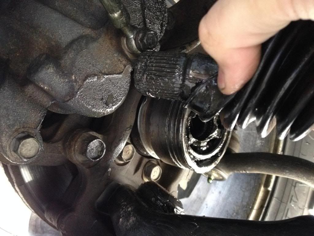

Has anyone ran into issues after Titan Swapping and running the Extended Axle Shafts for the R180?
I ask this because shortly after I swapped, I was on my way into work. My driverside tire dropped as I went over a manhole cover and I heard a *pop* and then at low speeds I heard clicking. Once I got into work I crawled under the truck to find out that the axle shaft pulled completly out of the cv at the tire/hub side.
On further investigation, the boot is fine, there is no more large hose clamp to hold the boot to the cv, the snap ring is still on the axle shaft, and nothing feels sharp or out of place within the bearing area..
Anything I should be worried about? I pulled the whole axle out, plugged the diff, and looking to rebuild the cv.
I did purchase them built, and really didn't do any checks on them other than basic physical oonce-over before installing..
Heres the pics I did get..
^the shaft isn't bent, looks this way from distortion due to iPhone camera..
**Any help from anyone that has experience with Titan Swapping and still running the R180 would be awesome! Thanks!

Whoever put those together didn't have the snap ring on the completely or even at all or else that wouldn't happen. Unless the snap ring wasn't the right size which wouldn't make sense... Did you get them from NissTec? If so I'd call and have them send you another set.

^^ What Kyle said... Is the ring on the shaft? I can't tell from the grease...

Yeah I have an auto, LE 4x4, and I know I'm golden for a M205 swap.. Hahaha I bought these axles used and built off of here.
Yes the Ring is still intact.

Sounds like you'll need to reassemble them.
I would completely remove all the grease and inspect everything to make sure nothing is damaged (including the boots). And like someone mentioned, make sure you have the right size c-clip on there.
