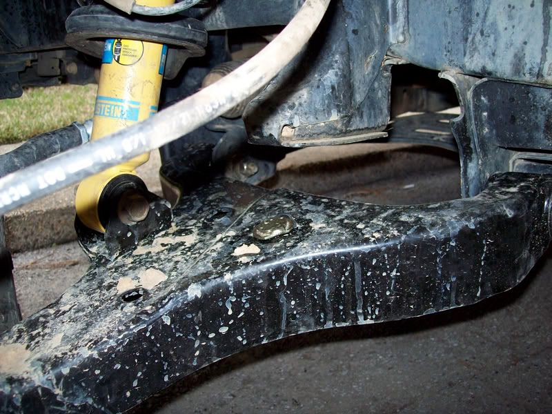

While taking a look at my front suspension today, I noticed one of my bumpstops got knocked off. I kinda saw this coming, but didn't think it would happen this soon. For those of you w/ Titan swaps, where did yall mount the bumpstop? When its in the factory location, it barely makes contact on the outside edge, and eventually is forced off. I didnt see an easy way to drill another hole further in due to the underside of the LCA. I might try out some aftermarket bumpstops of some sort if I cant figure anything else out.

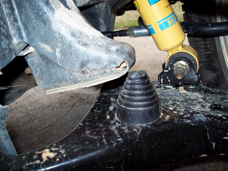

Ok here are the long over-do pictures. Its nothing special, just a bumpstop w/ the top chopped off so that it makes solid contact. It no longer catches the edge (which is what tore the first one off).
New one is on the left...
It still doesnt meet the whole surface I dont think but it does its job. I really didnt feel like taking the spindle off so I could lower the control arm and drill and tap a new hole.... so this will do! :D
As a reminder, this is the old setup
