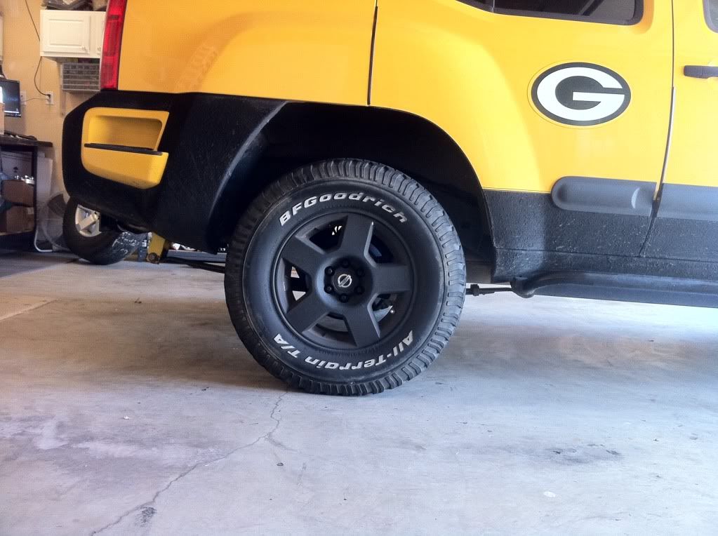

Factory S wheels on 265/75/r16's. 36" to the fender
this shows how far the wheels stick out w/ the 1.5" wheel spacers and 265's

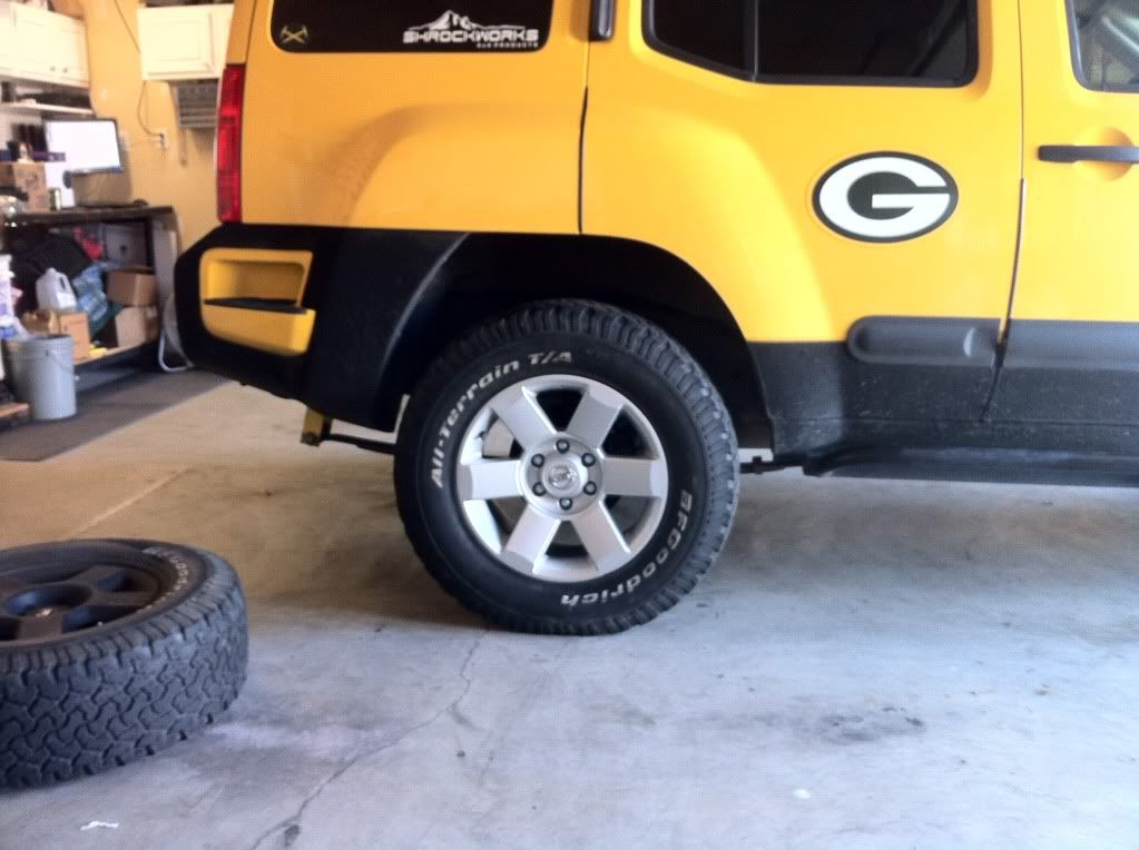

Factory Titan wheels on 285/65/r18's. 37" to the fender
Factory Titan wheels on 285/65/r18's. I jacked the body up 2" to simulate how it will look once I get my body lift installed. 39" to the fender

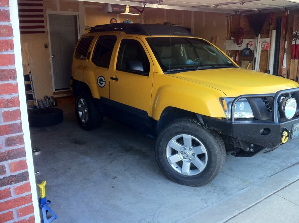

the front on 285's
this shows how far the wheels stick out w/ the 1.25" wheel adapters and 285's
comparison pic to show both

now these show the 265/70/r18's on the front and 285/65/r18's on the back. There really isn't that much of a size difference between the two. The biggest difference is due to the tread. the 265's are a highway tire and look tiny.
all in all, i really can't decide which size to go with. the 265's are WAY cheaper, but the 285's look better. Either way, the front liner will need some adjustment requiring more than the melt mod.
