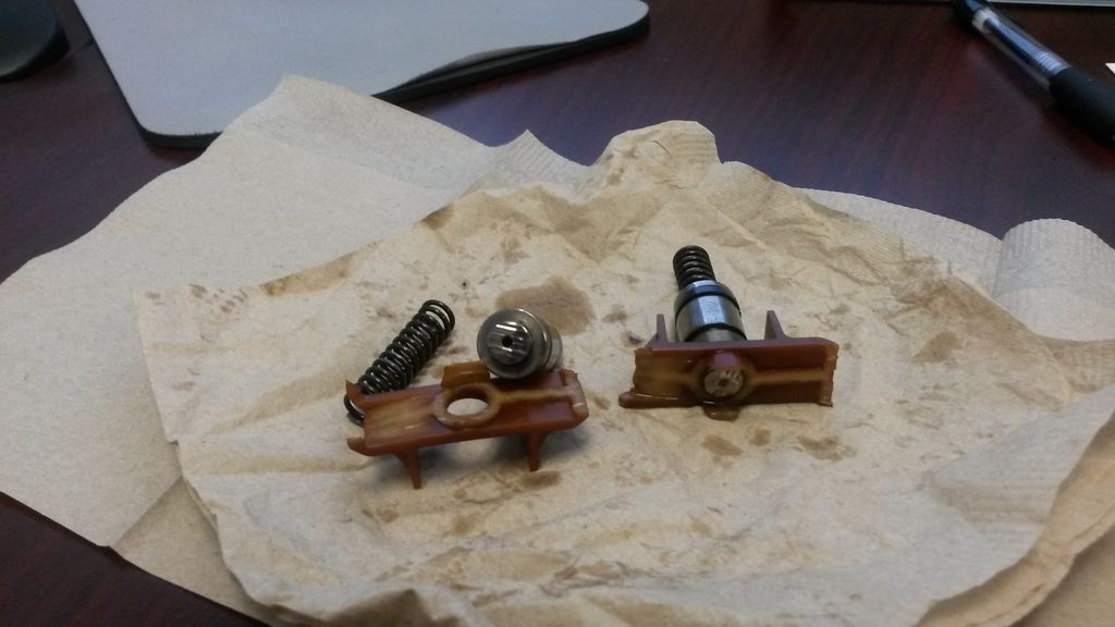

06 with 143K
it was waaay past time to replace them.
guides was completely gone and chain was wearing into the 'piston' that presses the plastic guide against the chain.

06 with 143K
Dang, pretty close to nothing left. I'll be having mine repaired Monday by the local stealership as long as I don't find a cheaper quote.

yea, the oil drain plug magnet caught a lot of the metal, but where did the plastic bits go? would prefer to think they are in the oil pan rather than jammed in a port somewhere, or picked up by filter & removed via oil changes.
Hope the pic would help convince people to get it fixed soon rather than later.
BTW: you have my mileage listed wrong.
Total cost:
Labor, timing chains (all 3), chain guides, gaskets/seals, water pump, thermostat, coolant, oil filter & synth oil came to $1480.33
water pump & thermostat are OEM, all others aftermarket. could have saved about $100 by not using OEM but considering how much I was spending, worth the piece of mind.
