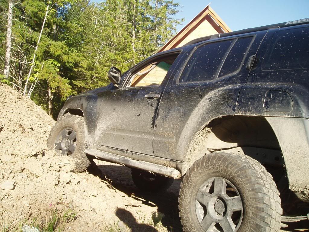

Mandatory picture of truck getting at least one wheel off the ground:
