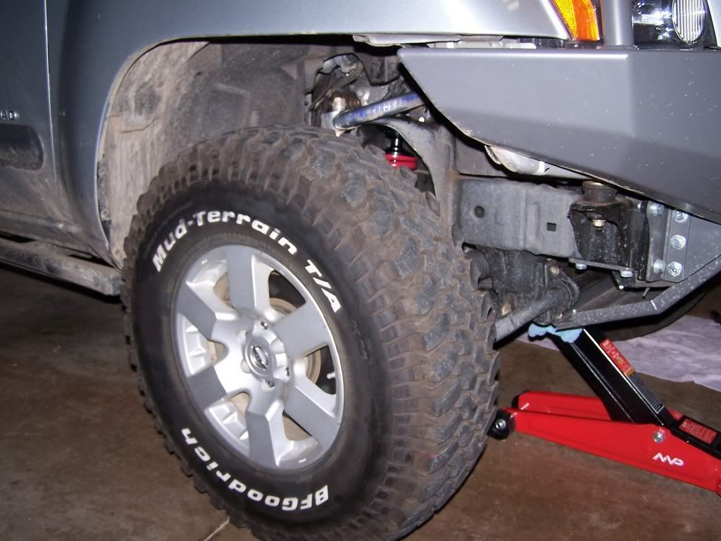

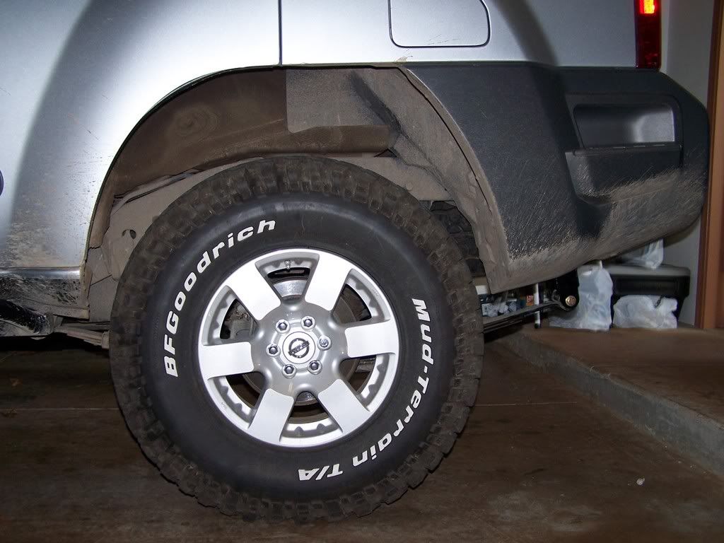

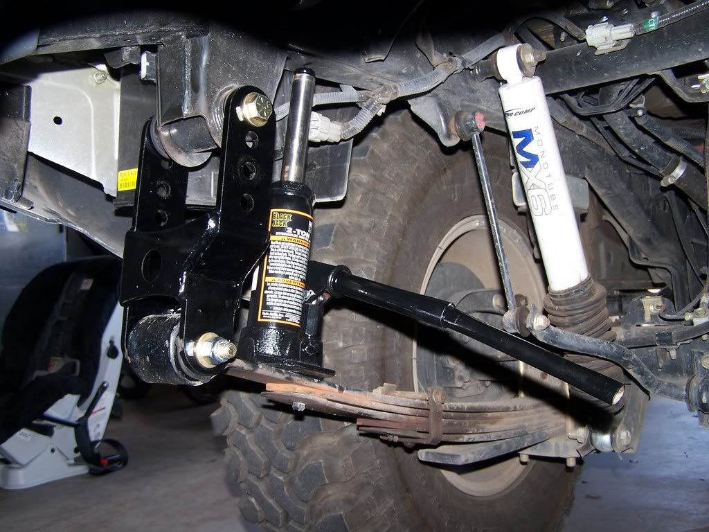

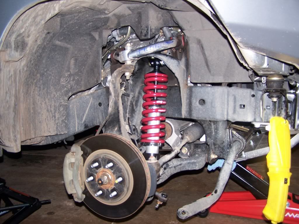

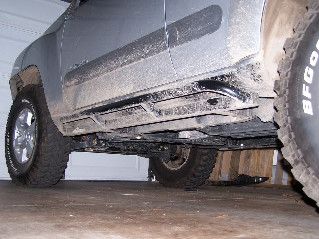

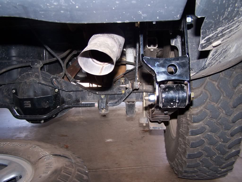

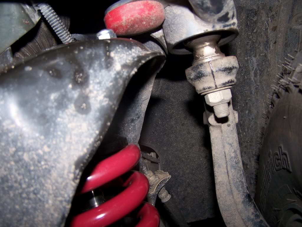

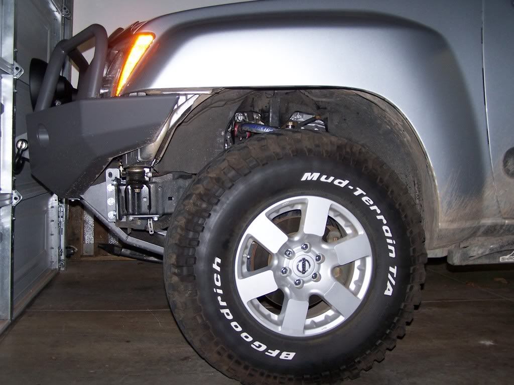

Howzit, I have finally come to a point where I am contempt with my xterra's suspension and lift. My suspension as follows: 3" PRG 750 coilovers, TC uca's, Calmini aal's, Pro-Comp MX-6 shocks, and PRG shackles. I am sitting at around 37 1/4" up front (3" over stock) and 39 3/4" out back (4 3/4" over stock) measured from ground to wheel well with lift and 255's.
PRG coilover installed.
Max droop.
PRG shackle install was super easy.
Front side shot.
Rear side shot.

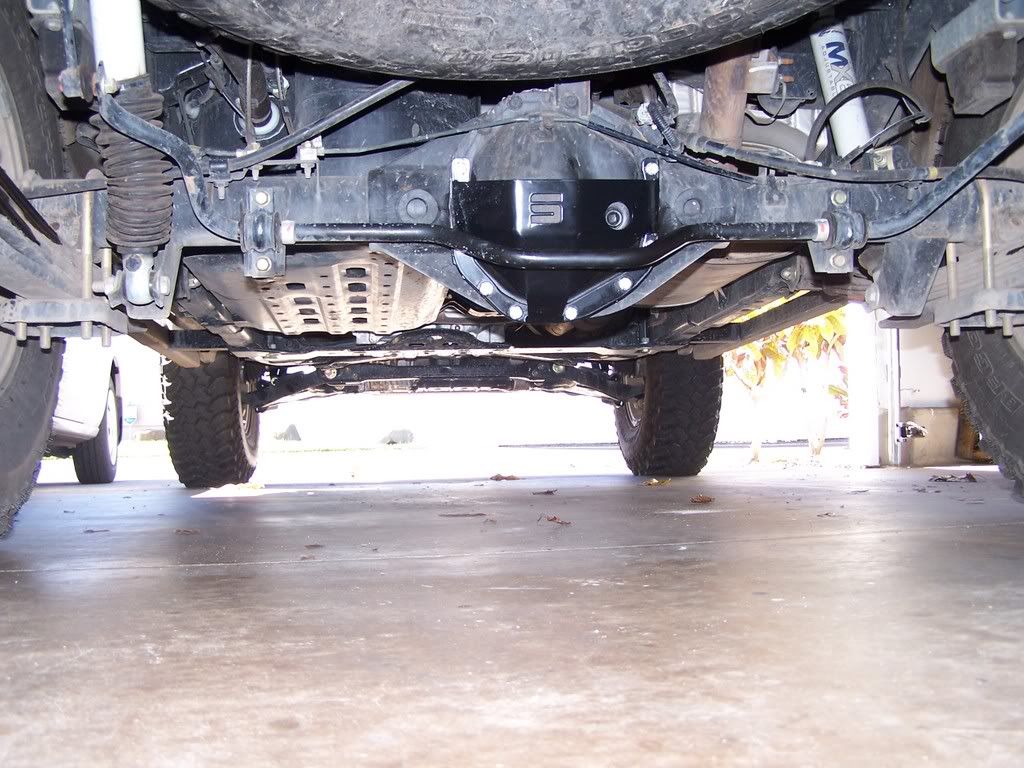

Ground clearance view.

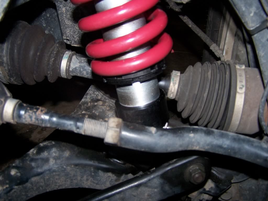

I adjusted the coilovers to measure 1 1/4" of thread from the top of the bottom mount to the bottom of the coil locking nut.
Leaves me with around 3/4" between uca bump stop and coil bucket.
I might adust the coil up another 1/4", but I'm not sure if I want to sacrifice the droop.
* Where do you folks with the 3" coilovers and uca's have yours ones adjusted at? IE. What's your measurement of thread from the top of the bottom mount to the bottom of the coil locking nut?
* Those of you with shrock front bumpers, 255's, and same front lift what are you measuring from ground to wheel well?
