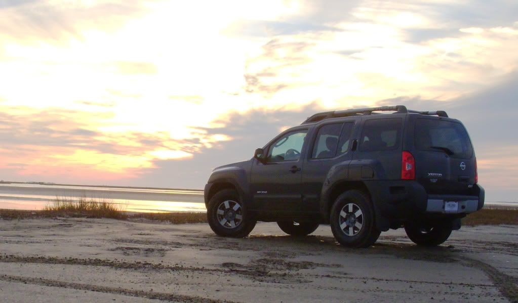

Back when first bought, took it down to the beach, still has the mudflaps and paper tags:

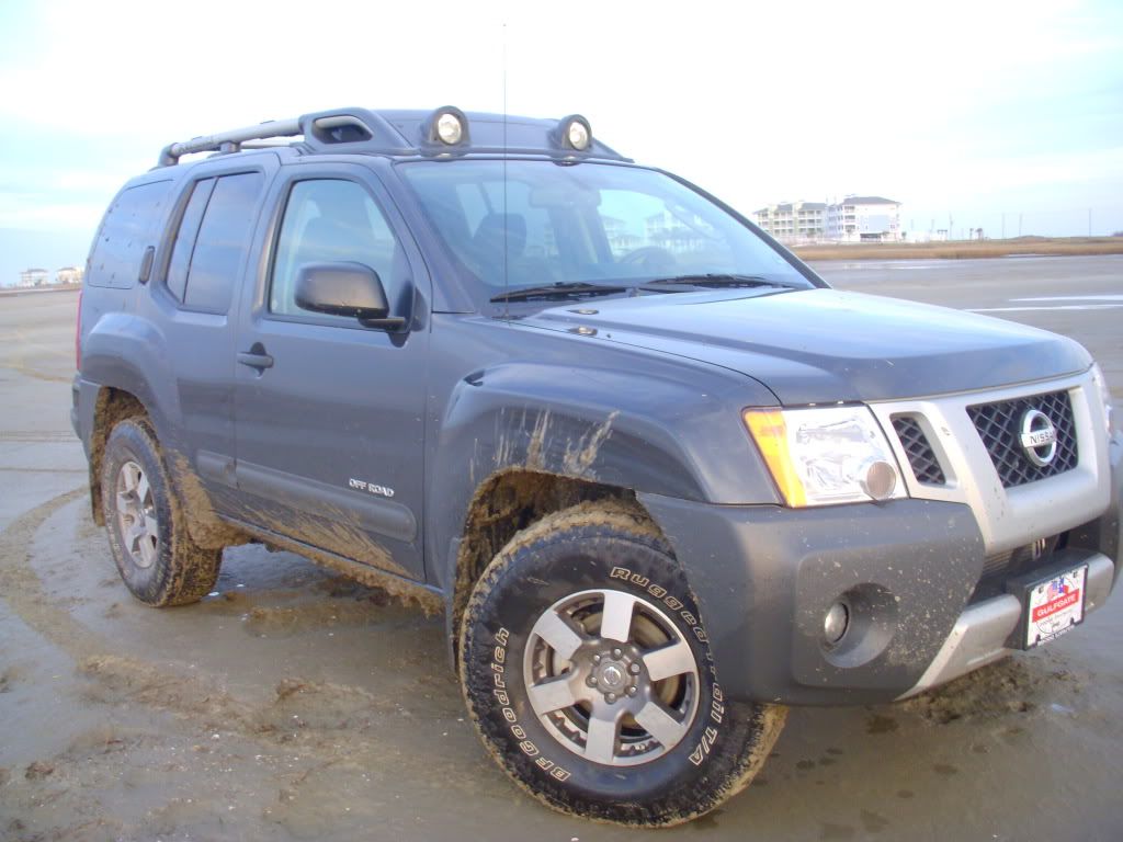

Put a PRG 2" spacer and AAL on, and some Kumho Road Venture A/T in 265/75-16 and went up to Colorado, on Engineer Pass:

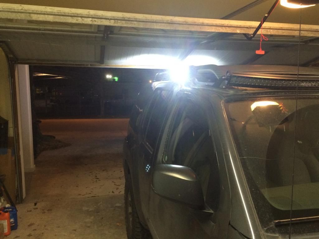

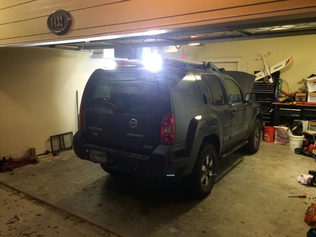

40" LED bar and roof light install:
Relays mounted to a piece of scrap aluminum:

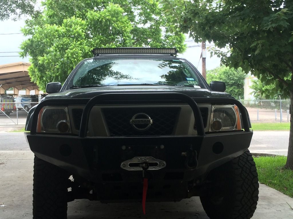

Most recently I bought a used shrockworks bumper locally and installed a smittybilt XRC 9.5 in it, pic is with it almost done, right after this I put the factory fogs into the shrock bumper:
