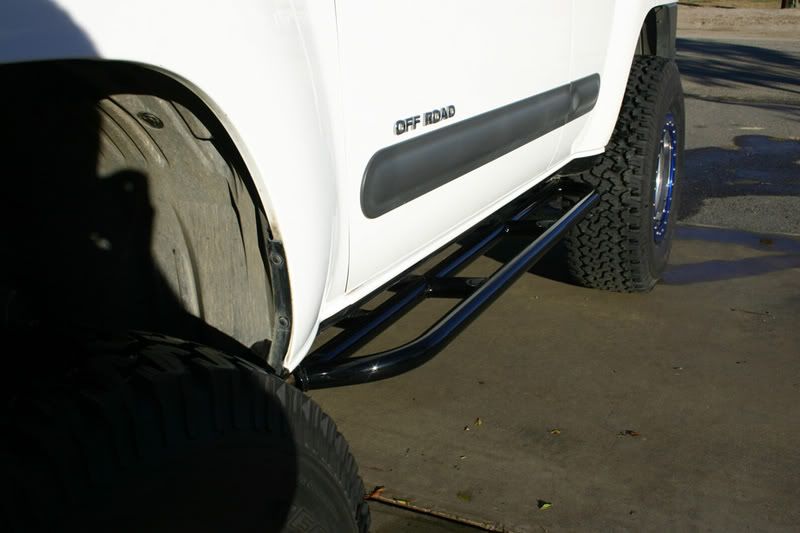

One requirment of the wife for lifting the X was that ingress and egress had to stay easy. Well, 7" of lift can make it a bit of a chore to hop in and out of the family car. So last week we made these. 1.75"x .120" DOM tubing, welded to the frame. They stick out a bit and work as a pretty good step. I still need to make fancy billet end-caps for the tubes, but I thought I'd shard anyway.

I've got the ShrockWorks bolt ons and have always wanted a tiny bit of a flat on top of the bar for my wife to get a purchase on as she climbs up. I've thought about skateboard tape to help.

I have the same issue, lowered wife, lifted X. The shrock sliders work good as a step, but a slippery when wet or muddy, I put non skid tape from Home Depot on them, now they work great as a step, and for roof access.
those would surely protect the lower part of the door too. Look good.

Those look awesome Greg! You should build em and sell em :D

Very nice work. They look like Shrockworks.

I had/have no intent on building these. They are pretty simple to make. I deigned them and paid my fabricator to build them, after powdercoat and everything, they were around $300 to make. I have no idea what the price is for the Shrockworks stuff, but thier stuff is nice and already availble. I suppose if enough people are intersted we can build them, but they will be weld-on to start with.

Looks a lot like the set Norshor made from Trailgear (?). I know he didn't pay much either... somewhere in the neighborhood of $200, IIRC. Trick is being able to do your own fab and welding work if you want to save money... I've got around $50 into mine.
