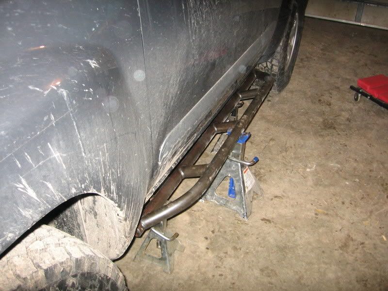

Well we started. Enjoy!!
Lined the sliders up against the X, to get an idea how we want them to fit. Used 3 jackstands. The only problem with jackstands, is that the don't allow for infinite adjustment, every click up or down, could be more or less than you wanted. I opened the door frequently, to find out how close we were to the body lines. I put a level in the doorjamb, and matched the angle to the slider. My X isn't perfectly level, and neither is my garage floor. Fun and games.
This is the front mount being held up against the frame with a small bottle jack. (The orange in the pic, is from my heater)
I put the first of the three mounts about an inch behind the body mount, so that I could weld a bead on that side. The bottle jack is there because the factory jack point is underneath the "L", which I will cut off once the braces are all welded up, and there is no clearance behind it for a c-clamp. I don't want to have to have HiLift with me to change a tire and would like to be able to use the factory jack. I had to watch this mount, because between crawling in and out while measuring and tacking these things up, it worked it way loose.
Center mount, with a tack. We tacked the center first, so we could pull the front or back, in or out and be able to pivot.
Another shot of the center support. This is the support that really counts in fitting up. Through trial and error, we found it best to pull the slider off to cut the other 2 legs by putting the other 2 next to the center mount to match length. We clamped them in the tripod and matched the outside legs angles to the center with a level.
This is the back mount, c-clamped waiting for it's brace.
At this point, we used just the center jackstand. Clamped that center plate to the frame, and used the level to line up the other 2 braces to their plates. Had to check the door sill many times to make sure it was at the same line as the slider. Lots of opening and closing of doors to be sure the braces were the right length, and that it fit right. Hint, if you do this, and you are the guy underneath the truck tacking the braces, before your buddies say its perfect and slam the rear door, make sure your knee is out of the way. Or you'll be pissed off that your limping the next day. Won't let that happen again :compress:
Finish-welding the braces and adding gussets. Burnt through all my wire, and need to get more.
I will try to get the other side tacked up Thursday. And then prepped and covered with TuffCoat.
Looks good, norshor. That sure is a pain getting everything lined up just right so the front and back are equal distance from the body, and everything sits level with the body. When I did mine, I cut the front and rear 'frame to tube' supports at the same length, welded them to the outer tube, then began the wrestling match to try to get the slider both level and lined up with the frame brackets. By the time I got to side two, I finally figured out the best way to do it was to remove the saddle from the jack and clamp the slider to the jack, then shim it to get it perfectly level; second side took 1/4 of the time the first side did, if not less. Plus I was doing it by myself, so that certainly added to the frustration. As it ended up, I think everything came out pretty level, but the front sticks out 1/4" further than the back; oh well, close enough (I still need to finish them and get them bolted up to see exactly how everything came out). So, I feel your pain!
Question- How far does your 'hoop' tube stick out from the main tube? Looks like about 7-8" to me, maybe? I ask because that is the final step I have left on mine... cutting and welding the outer tube to the main... and yours look about right to me.
Good job, man... can't wait to see the finished product!
