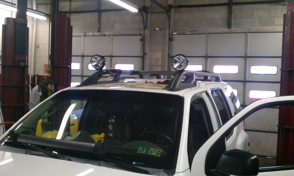

Next up was the nice set of KC 6" daylighters my wife bought me for xmas 2011 ...she rocks ! I Mounted the top lights direclty to the roof rack by drilling a hole in them. Too cheap to but a light bar lol.
I Mounted the front lights to the front gaurd . They are mounted sideways so i had to turn the lense to get the beam pattern right .

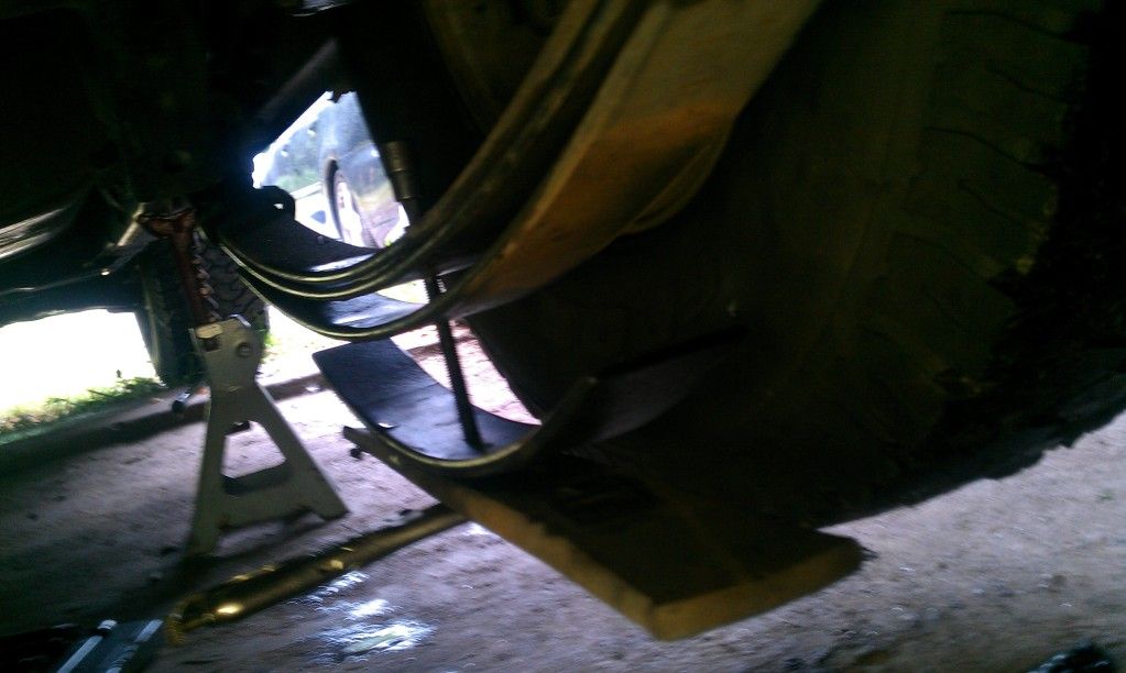

And first lift set up .. PRG front 2" spacers and the rear SpringForce AAL'S 1.5" lift for the back. Installed jully 2012 .
Picture of the AAL's going in ...

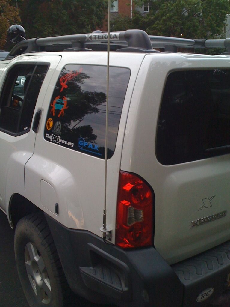

antenna installed
The antenna whip is mounted and cable installed . I purchase the antenna off of craigslist for $15 el cheapo . I ran the cable threw the tail light grommet and along the inside of the rear panels . pics ....>>>>>
white matches my truck lol

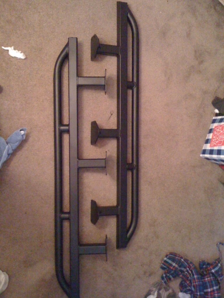

Sorry my photo skills are not the best but today went to look at a set of New powder coated AJ slider that are brand new from another member around the corner from me and while I was there bought his EGR rain guards that are almost new . He s said it damaged his front window tint but I don't have front tint so that's cool with me
simple snap in and go
Front ..
Rear just use double sided tape
Then I stopped into pepboys to grab a set of boot covers form my rear shocks and spotted these. I've been them wanting so I can replace the bright Yellow smiley face ones lol
more to come .. Monday I will post up pics of sliders stay tuned :iconbiggrin:

AJ slider
Finaly picked up my AJ sliders yesterday . They are powder coated back ready to get scratched . They will be going on this Sat . :bounce:

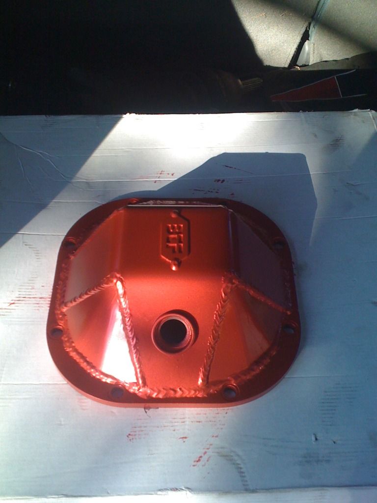

painted diff cover and new shocks
Got bored and painted my diff cover . It's a BFT cryptonite cover I won it at ECXC. I'm not sure about the color but its not too bright what do you guys think ...
So I looks like I had some mud mixed in the gear fluid damn! Look like I'll be running a long piece of hose off the breather before I go wheeling this weekend ! I Should have done the breather mod ..Duh
Here is the diff cover installed finaly Yay !

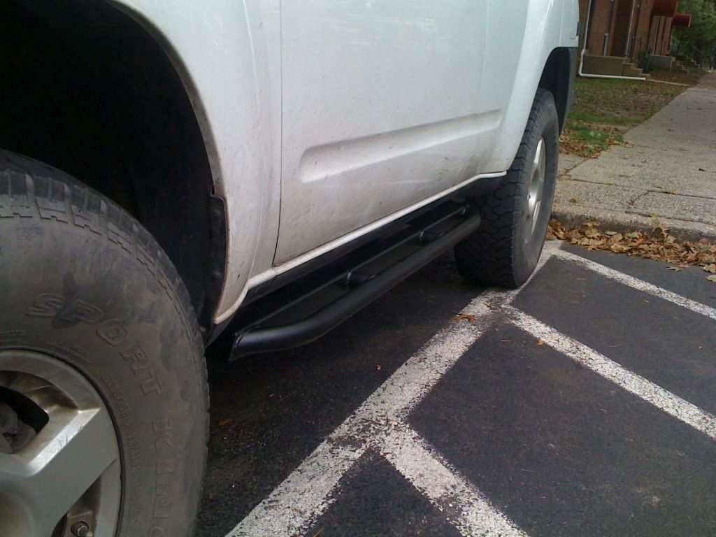

Sliders installed
Finaly got my AJ sliders installed today ! yay time to scratch them :headbang:
Drilled the holes and used the 14mm self tapping bolts . Not a fan of the idea of using self tapping bolt to hold them on . I think later I might fab a set of brackets to give it extra support .
