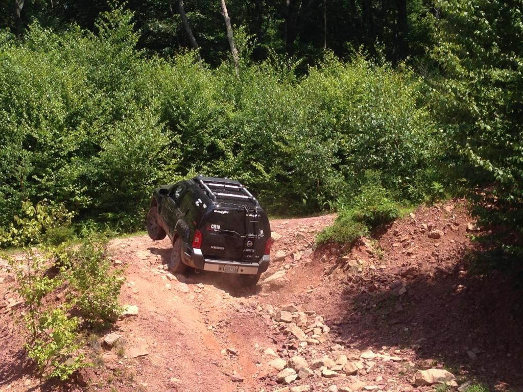

So went to Rausch for ECXC, was asked to lead with out ever being there before. Haha.
All good until I turned left and almost went straight into Frog Hole!
Realized how deep it was and tossed in in reverse and after about 4 minutes was able to dig my self out. It was too late, I wasn't fast enough and buried the pass headlight in the hole and got some of that beautiful PA muddy water in the cab. What a mess. It smelled wonderful by the way.
After cleaning out the whole cab and getting the 4 lbs of mud out of my door sill today, it's getting there.
But, the problem. After submerging it, I noticed shifting issues in the AT. It slams hard on downshift and it seems to loose power randomly almost like its in neutral for 5-6 seconds.
I checked the fluid and it looked clean. Everything else was fine with no codes. I thought something maybe got wet but not sure what I was looking for.
I have to thank Romeo over and over for towing my truck back to CT on his trailer. Did get to drive a lifted 1st Gen back, (missing that ol girl)
Well on its 5 hour trip home, with the wind, It must have dried everything out. She runs smooth as butta again. guessing a connector got a little more than it wanted. :eek:ccasion5:
