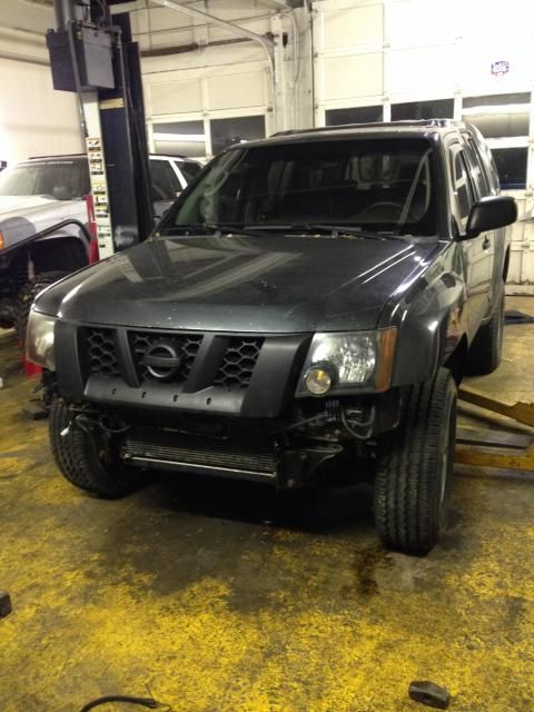

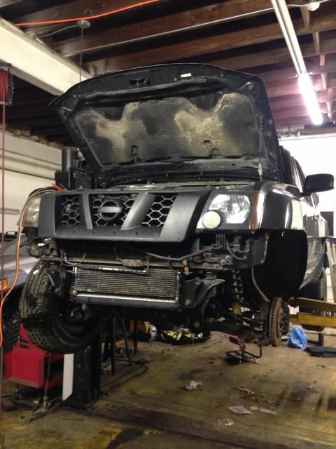

We blocked off the whole weekend and knew that even though it was only going to be a 2 day project we wanted to give it a head start. Mike came down on Friday night after work and we instantly kicked it into high gear, removing all the major components limiting us from access with the case.
Friday Night
With the bumper, grill, fan shroud, fans, alternator, PS pump, A/C pump coolant drained and all hoses removed it was a perfect time to break for the night.
