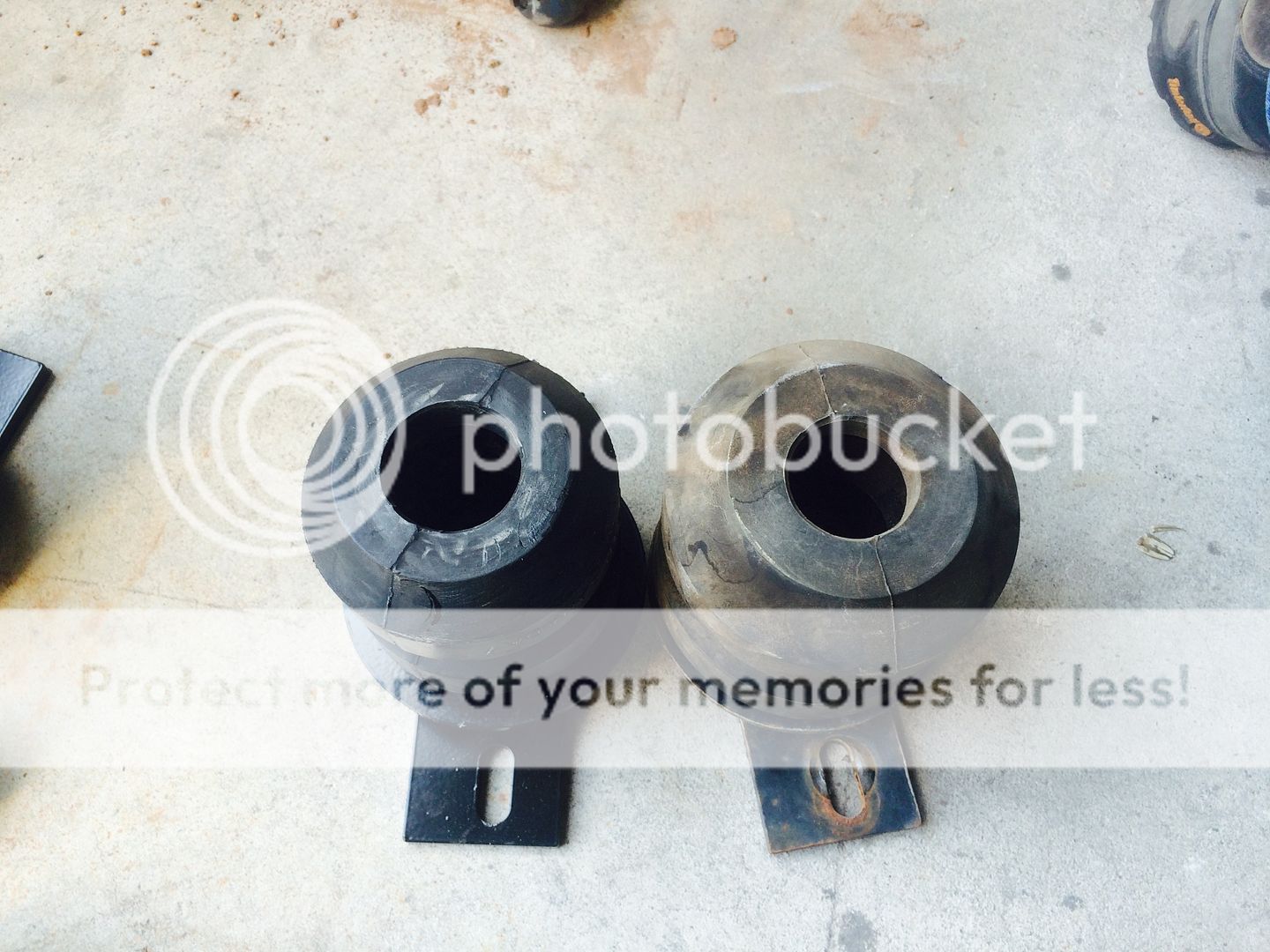

Rear bumpstops:
Rear units are slightly smaller dia and thinner than the SES models (new model on the left).
I took both and put in my arbor press to compress & feel the difference of each, and the newer model is softer and does compress considerably further under the same load.
I ran the older SES models for a while, and they were a huge improvement over the stock rubber covered pieces of steel that offered no cushion at all. On a hard bottom-out situation, they did have a short and progressive compression and fairly harsh rebound.
When I installed the new ones, immediately noticed a feeling of a longer softer compression and dampening, and no noticeable “bottom-out”, and the rebound is very smooth and not the “bouncy ball” feeling at all.
Even airborne over bumps and holes, it’s just cushy now. The wife noticed it immediately after install on a harsh trail we’d just been on recently.
