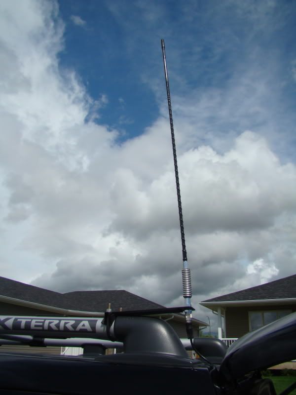

CB ant mounted (mount made by maillet282)

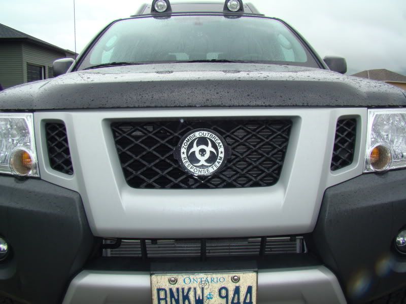

Zombie Burger added

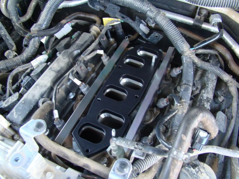

I also bought a Intake Manifold Spacer , havent got it in the mail yet, It will increase mid range torque and hp , site - http://extremetruckperformance.com/?page_id=6

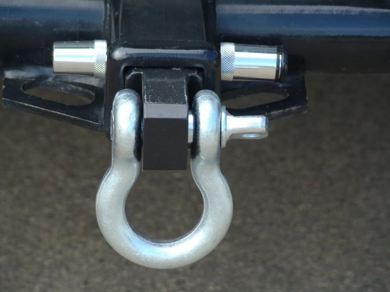

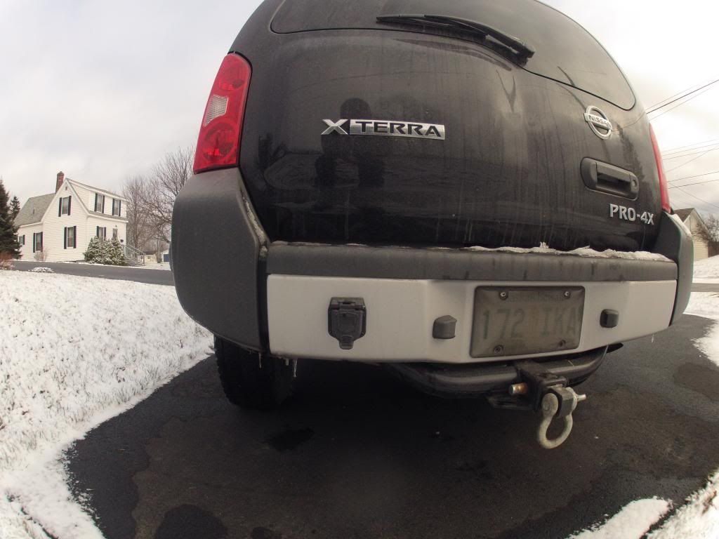

I bought a tampon (rear shackle that goes into the hitch) since there isnt any towing attachments in the back of the X

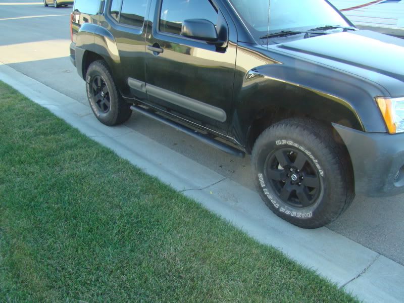

Well it took about 5 hrs over 2 days but they are finished. Stealth Rims Baby Ya
I did this all on a drop cloth on my hands and knees, I did 2 Saturday and then the other 2 on Sunday.
The prep is PITA but it is worth it. They turned out Great! Gonna wait a week or so before I was the truck or go on any dirt roads to let them cure a bit
Now if that damn IMS would come in the mail.........
