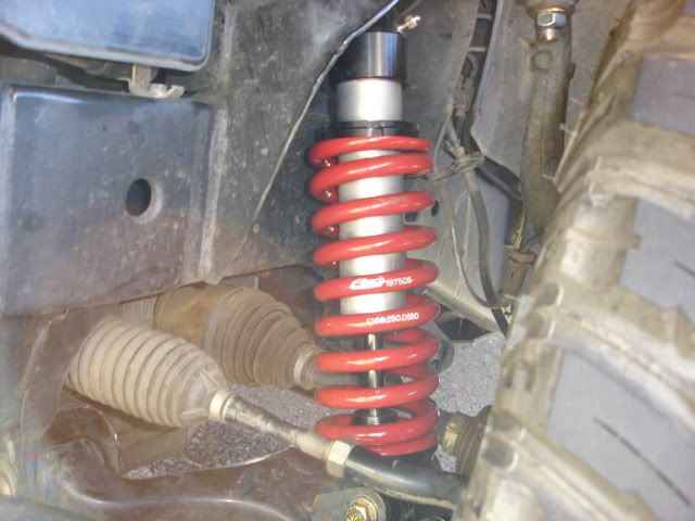

LOOKS LIKE THIS.........
These are the Titan 2wd 4" lift spindles and they run about $700.What was the price on the spindles? CST
adjustable from 5-7"What is the total lift that front setup will give?
The Titan Radflo's, DR's, SAW's are all 2.5"dia. (won't fit the X)... There is now a 2.0 radflo for the Titan but it's basically the same as the X but with different valving for the weight of the titan. Both offer 0-3" lift.Just wondering?, wouldn't you need the titan radflo's since
your going that far of travel. The X shocks are for 3 max,
but with your setup your going above that. I would run X radflo's
with coils spacers and diff drop. You could also run titan radflo's with
diff drop. This is for a 4x4 setup, not sure what u r running.
That would be great for the 4x4 guys if there was a diff drop available... well, there is the SLR kit finally!I would run X radflo's with coils spacers and diff drop.
without a doubt!take pics fully drooped and bumped.
