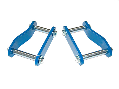

Since Daystar doesn't sell their shackles separate from the spacers, should I go with the Calmini shackles? As much as I've heard all the stories about their customer service, I used to have a set of their shackles on my old '02. I've been comparing pictures, and the Daystar's seem beefier. I know they're also greasable.
What do you guys think - Daystar or Calmini? $300 or $60?

I know some of you have mentioned that after lifting the truck, it would be a good idea to get the longer shocks and extend the brake lines, hence the reason why I'm now looking at these two packages. However, which one do you guys think would be better - the shackles or AAL's? I think I've answered my own question, since B SLater just put together that 05+ Xterra Lift Options post; I think "Case 3" fits my needs, which would mean going with the coils, shackles, brake lines and shocks.
However, I'm still curious...
If I go with the AAL's, how much of a pain is it to extend the ABS lines? Should I mess with those? And can the stock shackles handle the extra AAL's?
If I go with the shackles, do you think I still need to extend the ABS lines, even though it's not mentioned?
