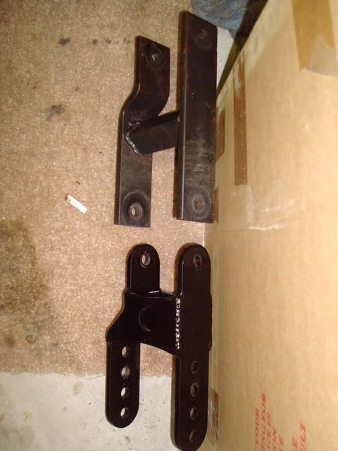

Well here are some side by side pics so you can compare yourself.
-Surprisingly the AC shackles and the PRG shackles provide the same amount of lift (when the PRG's are fully extended).
-The AC shackles use thicker steel for the side plates
-The PRG shackles have rounded ends (better design in my opinion)
-The PRG shackles look prettier (does that make a difference :blackeye: )
Well I have to say that since the prices are so much different, if money was an issue for me I would just go ahead and get the AC shackles over the PRG ones. But obviously i dont care about money :blackeye:

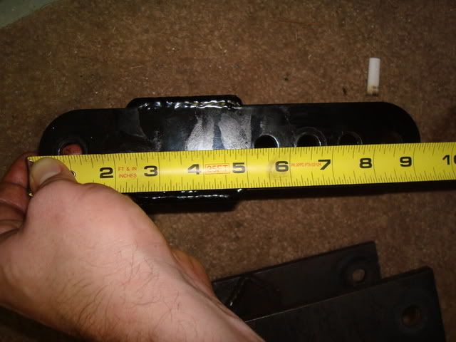

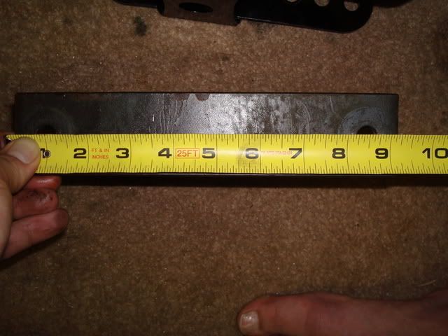

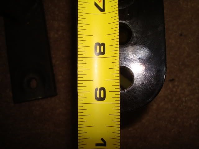

Measured from eye to eye on both of them (starting at the 1" mark)
PRG
AC
They both came out to 7-1/2"

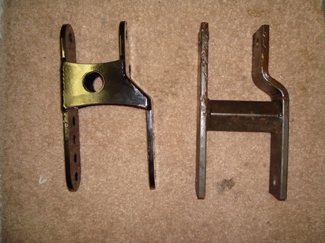

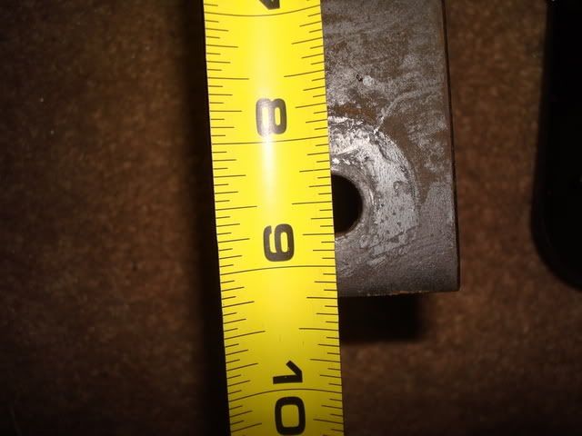

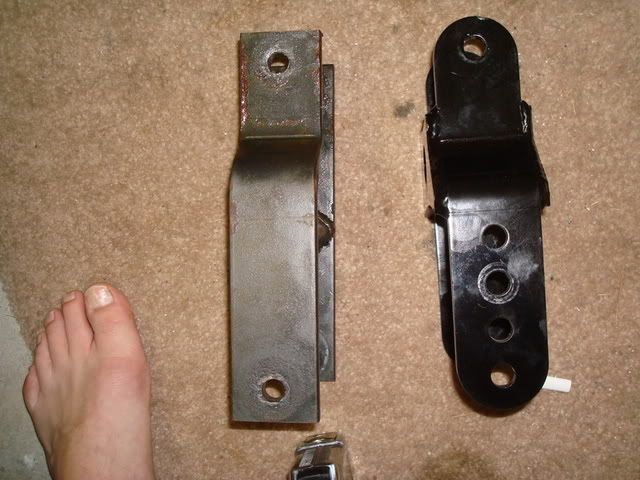

Some other shots

Hey sex, you left out one BIG comparison! Look at the face plates on the PRG's, then look at the welded square tubes (in the middle) of the AC shackles.
For those who do not weld or comprehend welding-the PRG shackles are far more structurally solid!!! not to mention the height adjustment feature is pretty rad.
P.S. get yer nasty arse foot outa the picture. jk--- :cheers:

I have the AC Shackles. They are working great. If you don't like the square cut ends you can take a grinder to them if you like.
The cross support doesn't matter all that much. The amount of stress on that point is not very great. Heck, a lot of shackles don't even have cross supports (for good reason).
The PRG might look pretty, but do they function any better? My guess....no.
BTW, the square ends on the AC shackle saves the wrap on the leaf from getting banged up when coming off a ledge, though the shackle gets beat up pretty good.

Maybe we can go back to making fun of your foot in that one photo...
