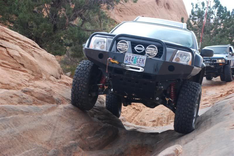

Great X build, tough truck.
looks great
i've said it before dude, you're truck is sick. everytime i see your threads i have this burning desire to just drop off my truck and pick it up in a week or two. that thing is cherry man.
btw, you mentioned the uniden twice.
Thumbs up homie! Looking like you're ready to roll in the last pic.

Amazing. I love your rig..
Sweet design and build out Oregon, one hell of rig man!
Sweet!
sweet!
That is a sick second picture, looks really nice.
Titan rims looks sweet.
Nice Xterra... errr... is it mostly Titan by now? HaHa
Tit-terra (Tight-Terra)
very nice stance!
