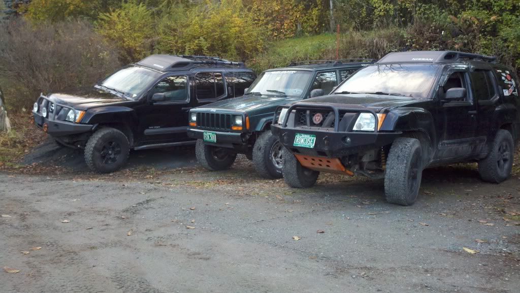

This is where it all started back in March of 2010:
First vehicle I had ever bought on my own. I knew I wanted a 2nd Gen Xterra but didn't know much other than that. Looked at a couple, this one had 88K but was in much better overall condition so I brought it home 2005 S model (don't mind the SE wheels), found this site and got addicted...
First things first, needed new tires, so I ordered 285/75/16 Treadwright Warden's, removed the mudflaps and step rails, and obviously started blacking things out:
Drove it like this for awhile until a friend from CT who had an X with a Shrock front told me he was selling his truck, and I needed to drive to CT and switch bumpers with him because the dealer he was trading his truck into wanted it as stock as possible. I made record time to CT :bounce:
He threw in the 9" Hella's for free.
For awhile I was watching the for sale section of this site literally daily to get some deals armor etc. Got Shrock Sliders, and a couple skid plates along the way with a 2" lift (there was a time I thought this picture made my truck look HUUUGGE hahahaha):
Things got Oranger:
Eventually I decided I love Xterra's and wanted to make it a super rig eventually when I got it paid off etc. I also started coming to the realization that the 'S' platform was not the most conducive to my eventual goals, so I was thinking about trading into an offroad model before I went too crazy.
One afternoon I stumbled upon this thread: Here
The truck was originally in San Diego with 35K miles, never wheeled for $19K. Had every Shrock component you could buy for it (no diff guard). Well, now the guy is in Lexington, KY, the truck has 45K miles and he dropped the price to $13,000. Well I quickly started PMing back and forth about feasibility of me flying down to KY to buy it from him. He was hesitant at first, as was I, but he seemed honest and I sent him some money to hold it for a month for me, so I flew down to Lexington on a Thursday, he picked me up from my hotel the next morning, and drove her home!
If you are ever in West Virginia in late October, take a drive along Route 33/55/48 from I-89 to I-81. Absolutely some of the most beautiful terrain I have ever seen. Especially with the leaves changing.
Got it home, did some posing:
At this point I had 2 Xterra's because I was selling things off the original, moving suspension over to the new one:
I got my first baby back to stockish and sold her:
Now, onto my current love... Black Betty :geek:
