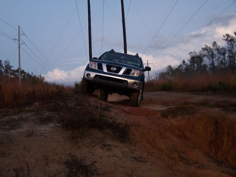

Heres a few pics I took tonight right as the sun was going down. A couple are blurry and would have benefited from a tripod, but overall they came out good. Enjoy!
In this photo, are those the factory fog lights that are on?
376 Posts
Yea, factory fogs. I wired them in the fuse box to come on whenever the parking lights were on. This also means they are on w/ the low beams AND high beams.
