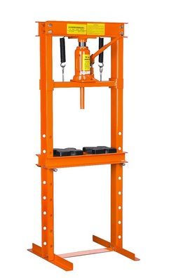

Hey everyone, been calling around to get my bearings/sleeves (m226) pressed on my rear axles and shops want want to charge like $50-$75 per axle... Well for that I'll go buy a 12-ton press from harbor freight for $100 and do it myself as I all ready have the old bearings/sleeves cut off!!! Then I got to thinking that someone may have all ready done this... So anyone have a press like this:
Video of How To (3:08): http://www.youtube.com/watch?v=WCYf4bgG6Xo

it'd have been $40 each if we needed to pull of the old bearings and such - if it was the c200 style axle where you need to pull the tone ring to do it. For the m226 style where the tone ring doesn't need to be pulled, it woulda been somewhere in the 15-20 per axle if we needed to pull the old bearings off. To just press on new bearings, we woulda done $20, but you'd have spent that in fuel driving up the hill. Or, a 30 pk of pibbers to use the press in my garage. But, this place still sucks and i'm going back into hiding...;)

You can also use a pipe and slam the whole thing down onto solid ground. I've seen it done this way, but never tried it myself.
I used an induction bearing heater to slide the bearing on like butter, but even after heating the retaining ring, it still took like 10,000 psi to press it on.
