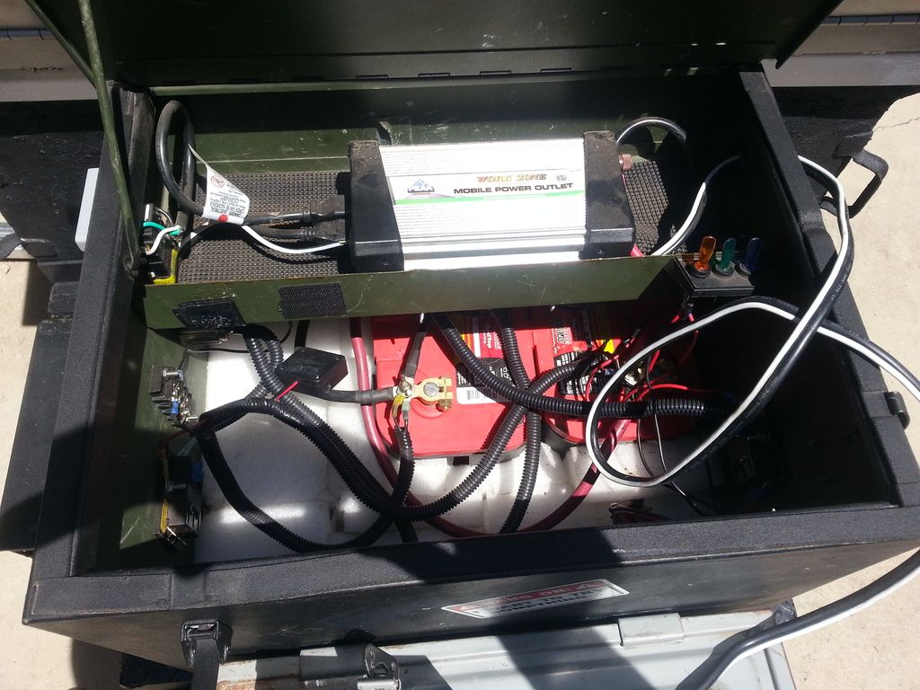

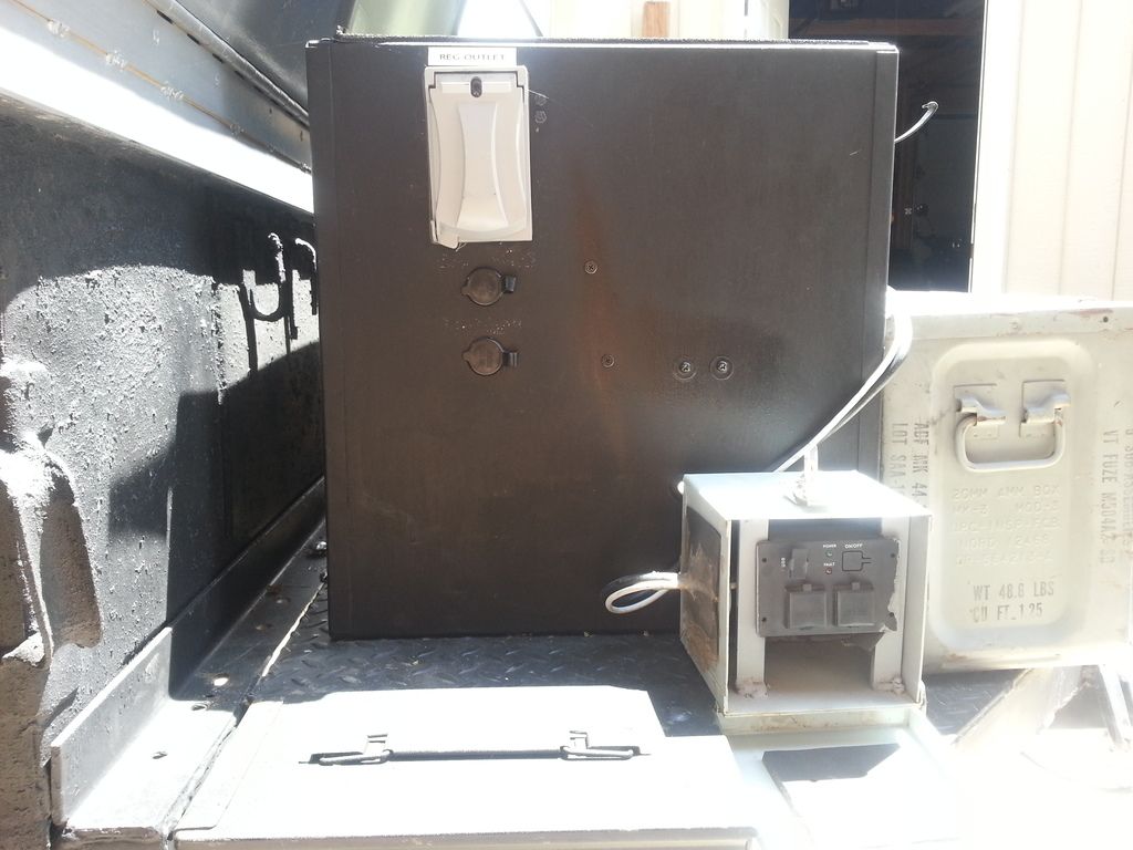

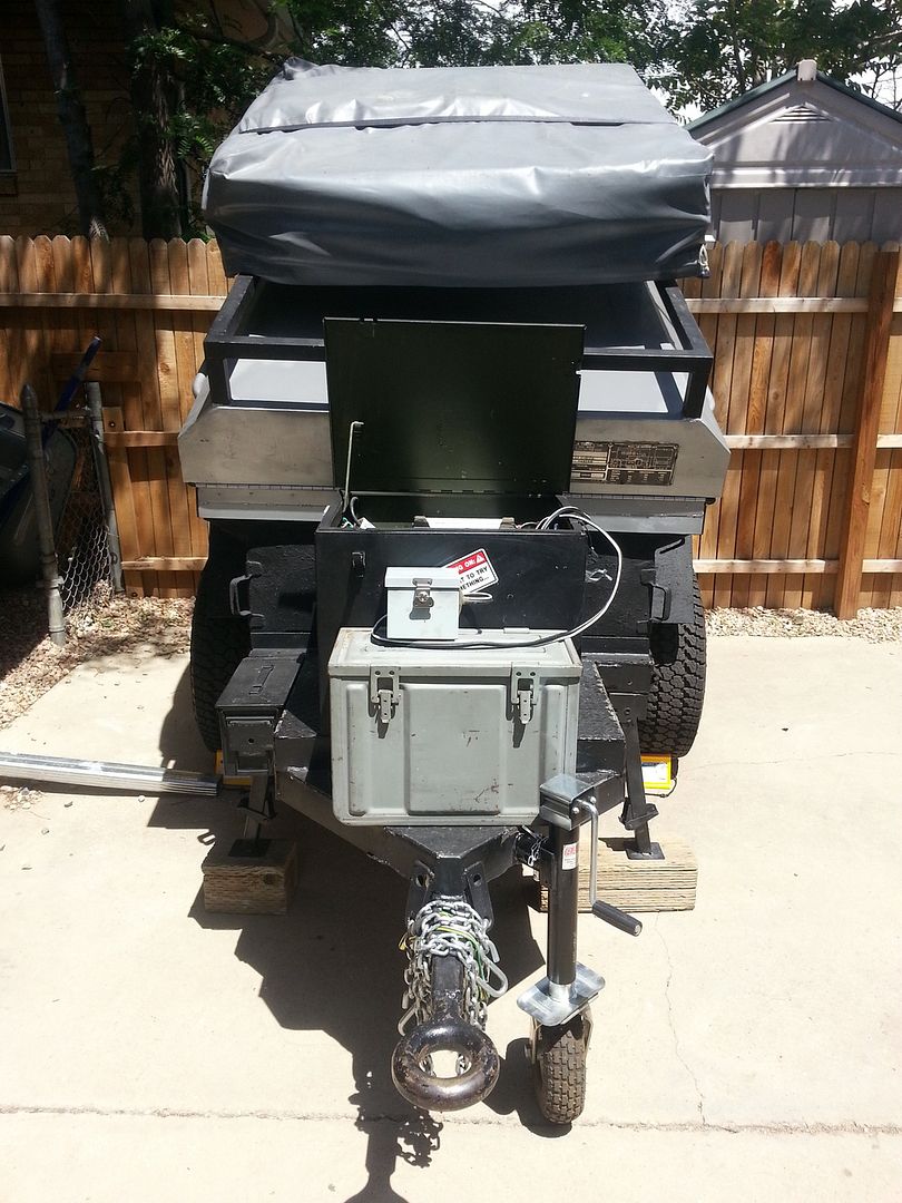

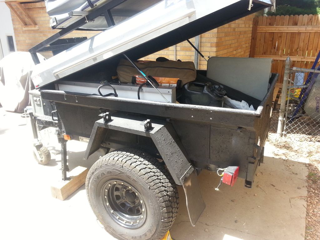

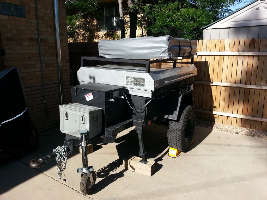

Original plan was Corey and I build a custom one off trailer, well there just isn't enough time in the day. So I found a steal of a deal on this '55 M416 locally so we will customize this and add all the final touches to make it more overland specific.
Original restorer was a local military man that restored it from the frame up as well as added all the extras and custom fab work. He kept all the original badges and re installed them however it is titled and registered in CO as a '99 homemade trailer. It was bought from him and it was used a total of 3 times. The shell is solid and rhino-lined (crappy job) and a custom steel cap and roof rack was added. The tongue was elongated and lowered and he added a home made battery box out of an military surplus container. There are also other various surplus containers bolted to the tongue for extra storage. He added a homemade solar panel that charges the dual, in-line red tops that are in the box. I plan on selling the RTT as it won't be ideal for my application. Here are the features and plans along with some current pics.
Current Setup:
  • 12V-4 Pin LED Trailer Light System
  • E-Brake
  • 4 - Stabalizer Jacks
  • 2-Red Top Optima's w/ Inverter
  • Custom Solar Panels
  • 2 - Outelts
  • USB Charger
  • 15 Gallon Water Tank w/ Pump
  • Hot Water Heater/Shower
  • Tepui Ayer Roof Top Tent
  • Custom Steel Topper w/ Roof Rack
  • Spring Over Axle Conversion
  • 2 - 5x5.5 Steel Rims w/ Faux Beadlocks
  • 2 - 31x10.5x15 Tires
  • MudFlaps
Future Plans (TBD):
  • Awning(s)
  • Lighting
  • Custom Aluminum Topper
  • Custom Aluminum Adjustable Roof Rack
  • Custom Dirt Bike Rack
  • Rotopax
  • 2 - 5x5.5 to 6x4.5 Adapters
  • 3 - 35x12.5x17 (Acquired)
  • 3 - MB TKO 17's (Acquired)
  • Wider Fenders w/ Mudflaps
  • Pull Out Stove and Sink
  • 2" Receiver/Hitch
  • Extended Mounts for the Stabilizer Jacks
  • Re-Weld and go over some of the work
  • Prime and Brush On Bed liner
  • Spare Tire Holder
  • LED Running Lights
  • Portable Runton 7W Solar Board (Acquired)
  • 11lb Propane Tank w/ Splitter for Hot Water Heater and Stove
  • Added Box Security
  • Max Coupler

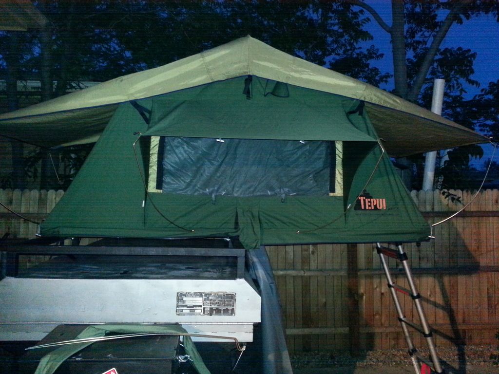

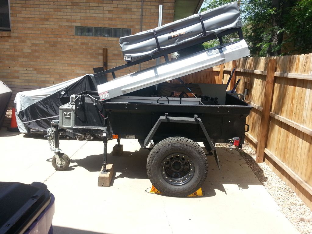

So the RTT is sold and I cleaned up some welds, sanded, primed and painted some areas that I felt needed some attention before I overhaul all the welds and paint.
I was thinking about relocating the battery box to the inside and making a ramp to drive my dirt bike up over it so it is sitting on the frame of the bike and strap it down from there. Anyone else have any potential dirt bike placement ideas?

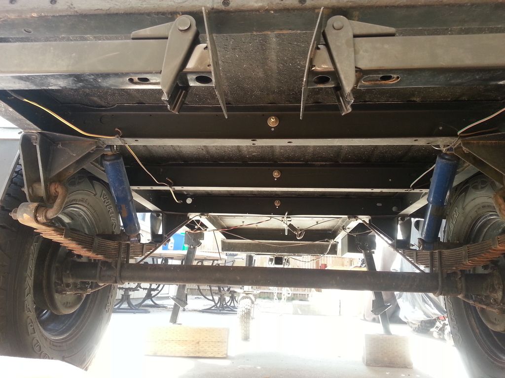

KRP, those timbrens look good, are they 2000lb total or is that per spindle? Either way, a great option for sure.
Well I scored a 1.4m Ironman4x4 Awning off craigslist for $120, it doesn't have the lights though. Also figured I should post the other trailer I fixed up and sold to help fund this one.
676 Posts
2000lb total.
All the MIl spec trailers I can find over here are the newer style for $1200, they are just too damn big for the X. I started looking into offroad trailer suspension and found these, look to be a great solution.
