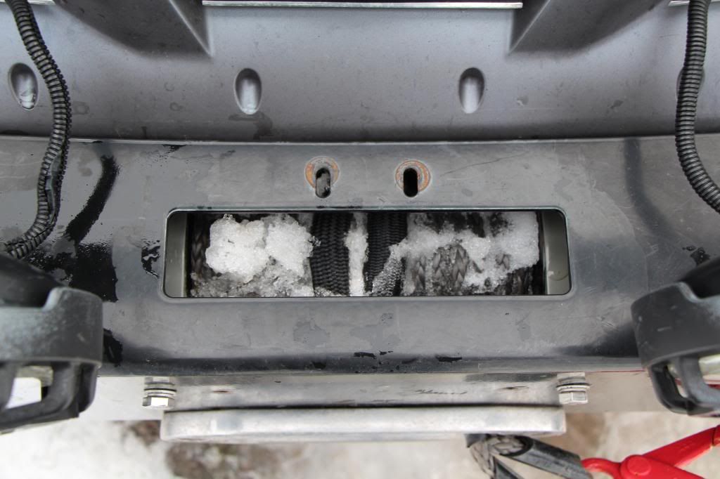

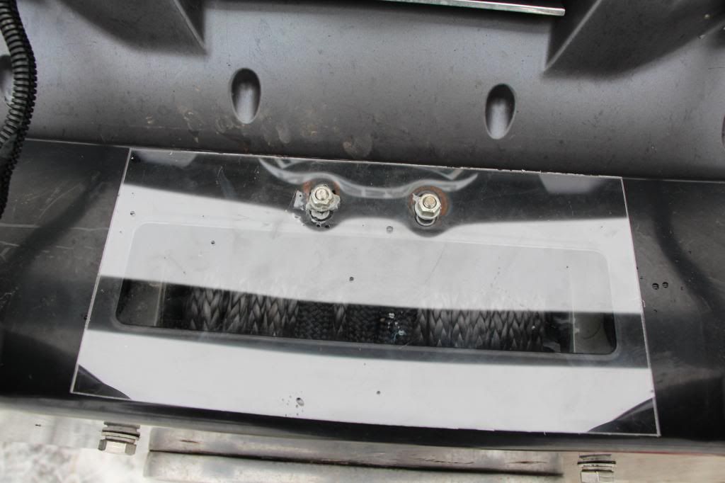

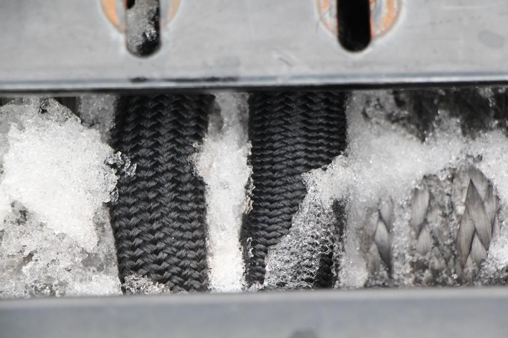

I've hated having ice & snow build up on my winch line through the opening on the SW bumper. Thought of a simple idea to prevent it happening again. Here's what you need:
1 piece of lexan 10" x 5"
2 bolts
4 washers
2 nuts
and voila...a see through cover ;)

I did consider that, but couldn't find a magnetic sheet thick enough work on short notice so I went with 6mm lexan (~ 1/4"). It does flex enough so I can bend the edge to get to the bolts underneath to remove it if I need to.
That being said, I'll look online for a thicker magnetic material as I agree that it is a better option... I'd still use bolts to hold it into place as far too often I'm using the scraper to remove ice from the bumper.

We had 20mm of sleet/freezing rain here last week and my line was a solid brick of ice as a result; It would not have made a difference with synth or steel. 2 days ago I had to use the weight of the vehicle on a decline and the power out on the winch to break the build up free.
