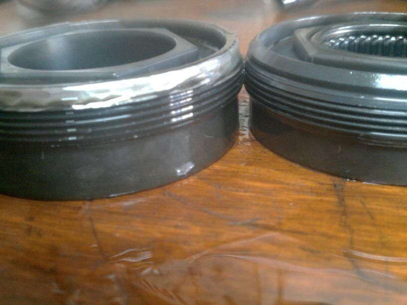

If your spanner nuts look like the one on the left ..
You need to make this adjustment... You can also machine the non-thread side, just do not machine the thread side..or so I'm told..
Maybe it's not a 2 rib or 3 rib issue more of a post 2010 issue.... that actually rings a bell from my conversations with Steeve..
For any additional technical information please contact Steve at Rugged Rocks or ARB..

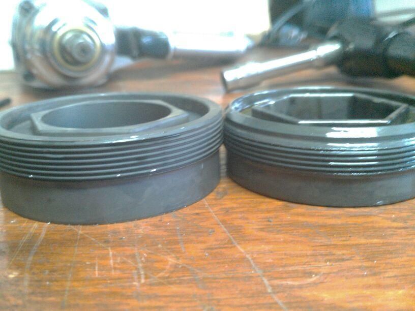

so it turns out i do have this problem. im going to take the spanner nuts to my parents tomorrow and grind a bevel on them with my dads bench grinder.
3,754 Posts
Ok. So just a little grinding on them so they "open up" a little wider?
I'm grinding mine now at my parents. Kind of wishing I brought the diff and everything with me so I can test it out before going home since I live 40 minutes from my parents house
4,548 Posts
^what year did yours come out of? might be helpful for other users.
Edit: why do you need to do this? is there contact issue somewhere? or will the carrier just not go in?
3,754 Posts
The one that goes on the ring gear side wouldn't open wide enough to fit the locker in. The ring gear was contacting the diff case. Mine is a 2010 M205.
3,754 Posts
It looks like they changed the design of those nuts and it was a bad move for this install
