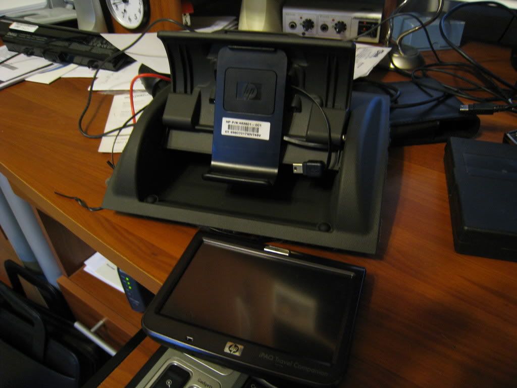

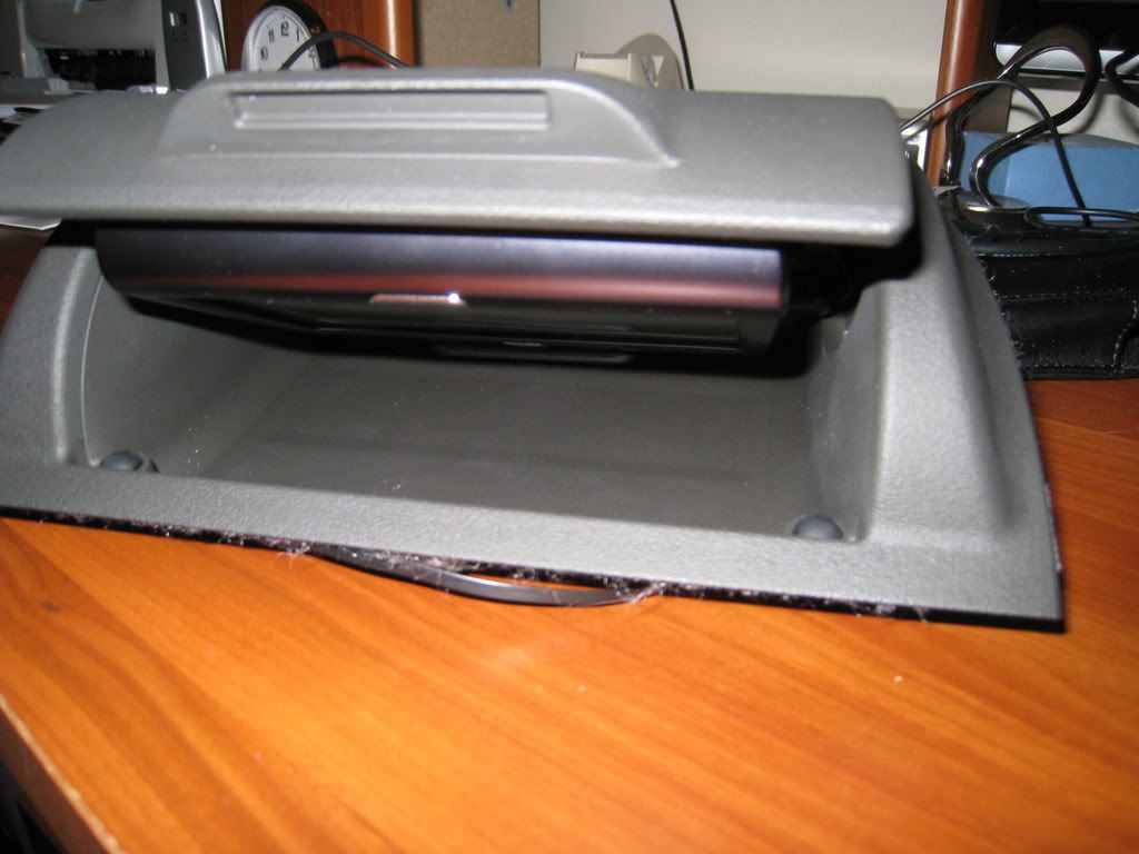

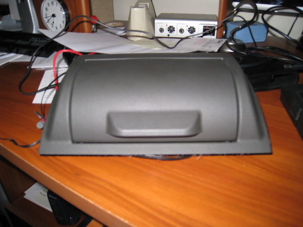

Well I got it done guys. I like the idea of the GPS docking station, but it sucked that it was Garmin Exclusive. WEll i've changed that. I was able to modify my GPS mount to fit. I did NOT damage the GPS docking station at all doing this mod which is great in case i want to sell it later. I have the Ipaq 310 GPS and got it to fit. I'm installing it tomorrow night and I'll have pics of the install up tomorrow or thursday night.

There is a bracket that fits onto the cover. Take the cover off and the other bracket off. I drilled one hole in the gps mount and there was already 3 holes in the back of the bracket one perfect for a screw. Made a few adjustments to the gps mount and made sure had the right alignment and drilled one hole 5/32 drill bit size. WOrked perfectly. It is stable as can be. Dremeled the screw in the back to where it was flush.
