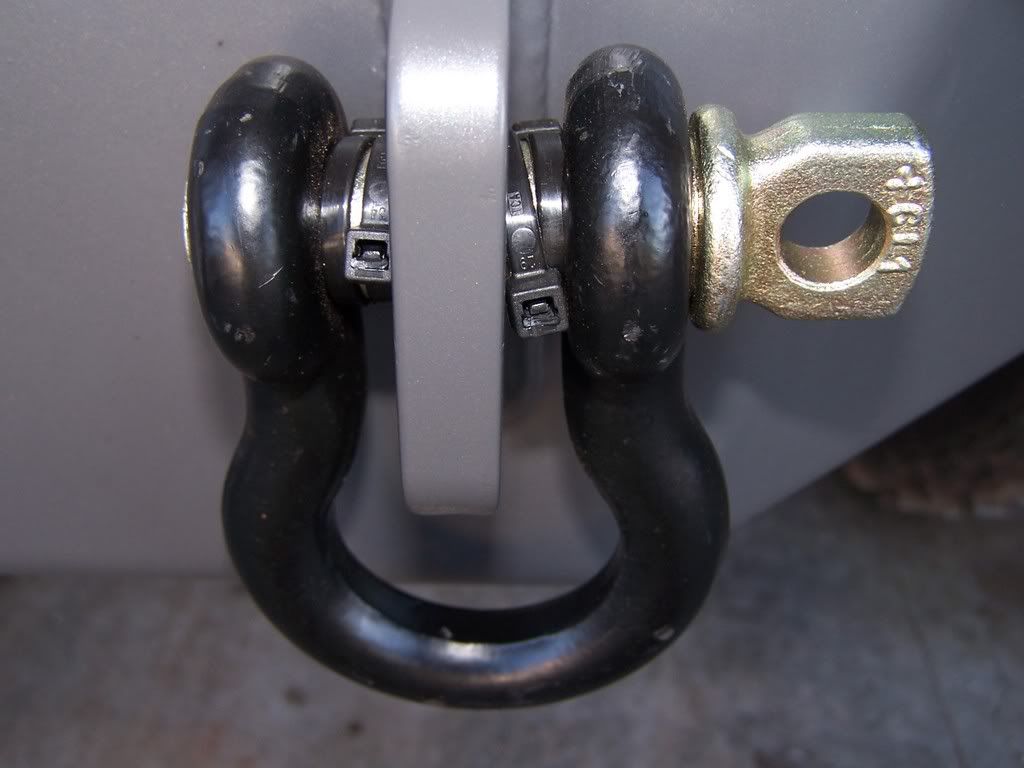

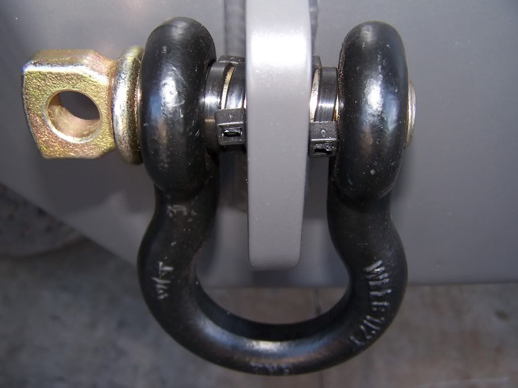

Howzit, So I went to both Home depot and Lowes and was unable to find any rubber grommets, bushings, or washers for the size required. Frustrated I looked in my garage to see what was readily available and thought why not use the zip ties! I'm using two zip ties 1/4 in. wide on both sides of the shackle mount, for a total of 8 zip ties all together. They have been doing the job perfect with no rattles or slapping.

If you can't find any grommets, how about using a a short section of garden hose or something.

If you want to make your shackles look like MCs in his shrockworks install you need to use gladhand gromments. He said you can find them at truckstops just laying round the parking lot. I bought mine from a trucker supply store called Interstate Safety.
I bought a pack of 50 red urethane large face gromments and each shackle takes 2 1/2 or 3 gladhand grommets. 50 will cost you $22 + 8.50 or so in shipping. About $.60 a piece.
I'm willing to sell 6 gromments each to the first 6 guys that PM me for a total of 5 bucks, I'll pay the postage. 6 gromments will stop the rattle on 2 shackles. If you have shrockworks front and back you need 12.
We'll work out the means of payment in the PM. I have a paypal account but have alway brought stuff with it not sold.
MC was right, once you get these on, they are solid and no rattle and I would be surprised if anyone could get that shackle off with out some serious tools. The hole of the grommet is smaller than the clevis pin and the urethane stretches so they are on there tight.

Howzit, Hey hawkinsw thanks for the link, I am definitley going to order a bunch of those gladhand grommets. That's exactly what I was looking for. And k1w1t1m don't worry about my shackles being stolen, I have them torqued mean kine! You'll need a pry bar to steal them. Aloha, nalu's one

The rubber grommets from Home Depot if you are still wondering are in the plumbing dept. near parts for toilets. They are called I think petcock flange grommet or something to that effect and they are in this red and green and white packaging. Good luck.
1,123 Posts
See the next to last post in this thread http://thenewx.org/phpbb2/viewtopic.php?t=2468&highlight=
25 Posts
Right that is exactly what I was talking about. I wasn't trying to take credit for the idea. I was just reposting an idea that someone else came up with and it is what I decided to use myself to keep the shackles from slapping.
25 Posts
Kneebuster, Thanks for adding the link of the picture that I was talking about. I could not remember where I had found it before. These things work great they just take a few minutes to get them set in there right.
