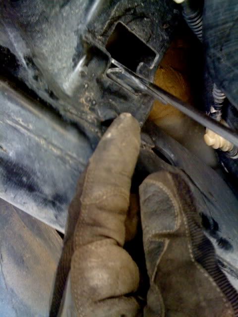

4) Loosen all 3 bolts that hold the tank straps to the frame.
The rear strap has 1 bolt and a hook and the front has 2 bolts. Here's the hook.
5) Use a floor jack, some bricks or a buddy to hold the rear end of the tank up while you remove the bolts, because you don't want to let the tank dangle from the plumbing and wires that attach to the top of the tank near the back of it.

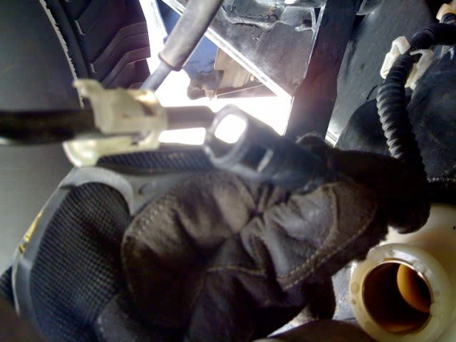

6) Lower the front of the tank to the ground and carefully disconnect the plumbing bits and the wire harness. Here's the tube that fills the tank up.
There's two gas lines like this to disconnect, one on top of the tank and one out the back near the filler tube.
Another tube....

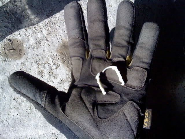

Don't break the clip that holds that last tube on. :(

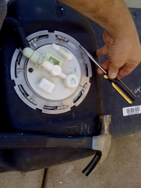

8) I forgot to buy the special Nissan fuel pump remover spanner thingy and had to carefully bang the assembly with a screwdriver and hammer. One hit per notch all the way around several times loosened it up enough to get it off. Had to put it back on the same way.

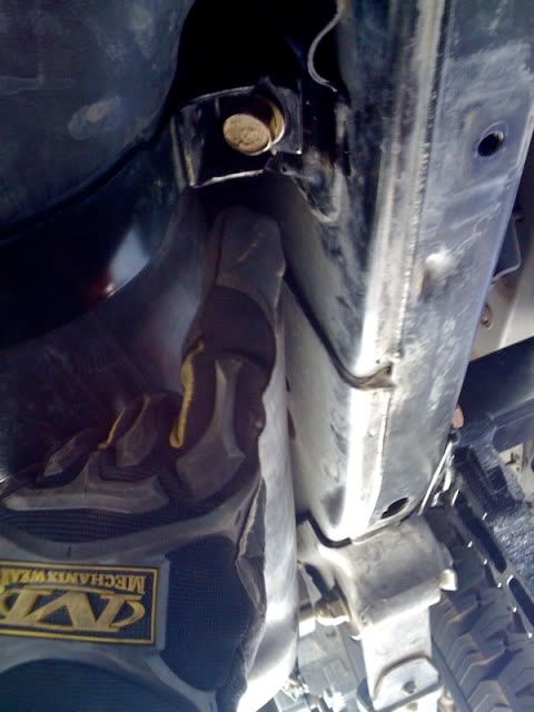

The only problem I encountered other than the busted clip was a stripped out nut that holds the front tank strap on. I suspect the stripping occurred when the truck was made because I had a tough time getting the bolt out when I first tried to take it out. This guy right here...
With the skid plate back on it's secure, but I will definitely get that re-threaded because I suspect a secure gas tank is probably important. Call me crazy. I also intend to get another little clip, but I stuck the two halves where they came from and gave them a good tug. They feel like their not going anywhere.

Uh yah...i broke that last clip...only becuase it was a PITA to get off. I just shoved that thing back in there and zip tied it super tight.
Im pretty sure it was just the vapor recovery tube.

Did anyone not break the clip? I think the new tube that has the replacement clip was like $20-$30 so I electrical taped mine in. I wonder if its still there.
