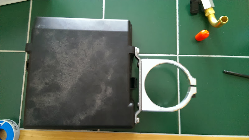

I took some time trying to figure out where to mount this. The area near the air box seemed like a viable option, there is plenty of room to work with, and users on here + clubfrontier used it as well and it seemed to be functioning / collecting fine for them. But I was hesitant to run cables that long (the existing PCV cable is less than a foot long) and Moroso only included 3 ft of cable. I also checked the install examples on Moroso's website, and they too were short runs.
Ultimately I decided on this. The cover to the engine fuse box. Its surprisingly robust and handles the catch can fine.
At first I test mounted it (both on and off the truck).
Another test mount view:

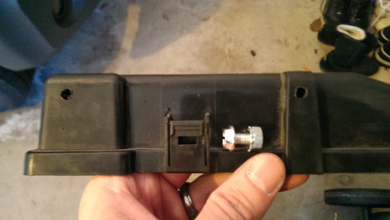

Then I drilled two tiny pilot holes on this side of the lid. (The drill bit is in view.) I also shoved the drill bit in to the hole and re-fit the lid to test for depth.
Everything looked good. The height of the holes on the lid are above and clear all the wiring / fuses / relays in the box. Drill bigger holes to fit the locking nut and bolt I had on hand. (These bolts did not come with the Moroso, they were extras I had).
Under view of the mount and screws installed on the lid. (Note 1 locking nut fit, but the other was too big and I used a regular nut.)

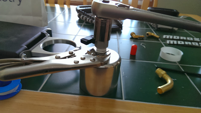

Next I began to put the Moroso together. Use teflon tape.
The Moroso in general has some very tight fittings. Here's a view of what it took to crank on the drain valve.

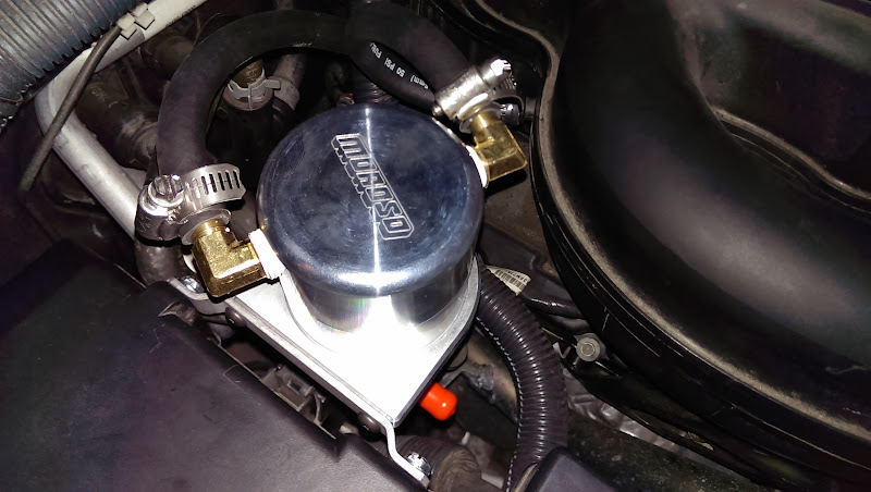

This one picture shows pretty much everything. The Moroso hooked up and connected. I did a bit of adjustments to get it at the angle I liked, and easy access to the drain. I also FLIPPED THE MOUNT, so that the alan wrench screw head was facing towards the firewall, this makes it easier to tighten. The left tube connected to the Moroso is the same tube cut and clamped from the picture above. Then with the remaining tubing, connect the remaining nipple on the Moroso to the intake plenum. (The tube on the right side in picture.) Note: There is no inlet or outlet on the catch can, its an in-line filter, so it doesn't matter which hose goes where. Lastly tighten all clamps, and tighten the mounting base to clamp the unit in.
Another view of the completed install:
I fired up and ran the Xterra for a bit. Everything seems solid. No leaks, no check engine, ran fine.
