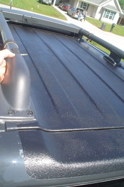

After cutting some bolts on my roof basket with the sawzall several months back I noticed the flecks of hot metal burned thru the paint and have left little rust spots all over the place.
Knowing this wouldn't fly as warranty claim because of the concentration of the spots... and just because I'm a generally honest person I didn't attempt to have nissan cover it.
Also along the top of the hatch had gotten pretty beat up from loading the kayaks and left the paint scratched to h#ll.
I pulled the basket,
masked everything off,
sanded,
applied rust inhibitor,
primed,
rollled on herculiner,
pulled off tape and voila!!!
The white stuff on the edges is tape residue that i still have to take off after the herc. cures.
And with the basket back on!!

yeah, rolled it on... it's about 85 degrees out and being on the roof I think let smooth out a bit.

That looks great. That is such a good idea! The stuff is after all a truck bed liner. I just hope the sun there in the south doesn't melt the stuff away.
What rust inhibitor did you use?

No melting happening... it's pretty much polyurethane so once it cures it's hard as nails!
I used a product called Rust Converter by Klean Strip. It's like a zinc coating that you can apply right over rust and will convert/prevent rust and is also an effective primer. Comes in a small (about 8oz.) bottle... i think you can get it at wally-world, if not, probably hardware or auto store.

Pretty cool! Just be forewarned that Herculiner fades badly. I believe there is a UV inhibitor that prevents it. Another idea is a quick hit with some black spray paint to keep it looking black.
