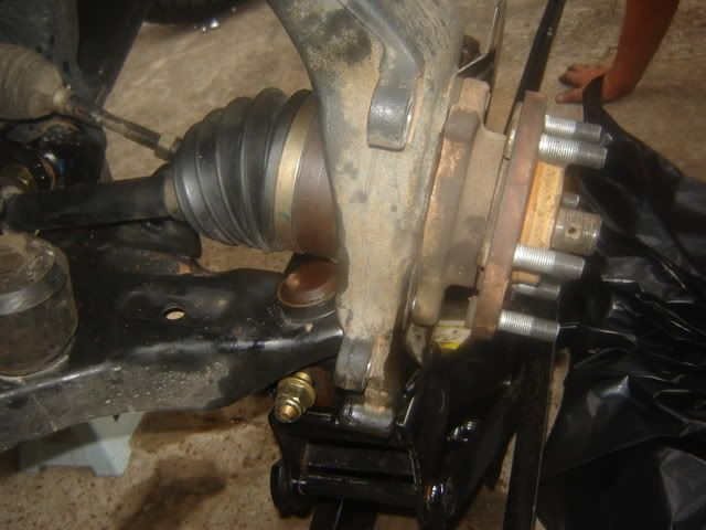

Im installing my calmini lift right now and I can get the damn half shafts out of the steering knuckles. does anyone have any info on this... the quicker the better guys..... here are some pics.
How the hell do you get the CV out of the knuckle????

so basically i just knock the threaded bolt thing with a BFH and it should pop through the knuckle? RIGHT?? There isnt a 'c' clamp or anything holding it in? I tried knocking on it with a SFH and it didnt seem like it was doing anything. Would it be a good idea to put the nut back on then hammer on it?
Also, if the half shaft comes out of the differential... is it easy to put back in??? Look what happened.

I have not done one of these but the one's I have done, it just kinda pops out. It's held in with a sort of clip like a snap on a shirt lets say, it pops in, and pops out. In the look what happened picture, that would be what I would expect. And that's ok, it will pop in same way it popped out. MC

It looks like you've got everything disco'd properly. I think you're just looking for a sweet spot now. The CV has to bend at two points to disengage, then it should just slide/pop out. Who's helping ya'? Just breathe deep and try again before administering the calibrated knockometer..
ETA- maybe lower your floor jack? work on the angle to pull it out..

Okay guys its raining cats and dogs, but i decided to go ahead and give it a go! All worked out perfectly. All I had to do is put the large nut back on and give it a couple of good wacks with a sledge hammer.
