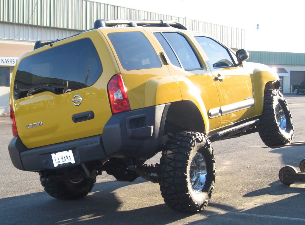

Message Body: I am very excited about learning as much as I can about my X and all I can do. I bought my X already built with great modifications. It is the "La Rana" and I have seen great things from it. I am in the military so she has seen a lot of military posts within the past year, so hopefully we can get more off road time soon.
Username: shawnsororian - LA RANA
Year: 2005
Trim: Off Road
Transmission: Automatic
Color: Solar Yellow
Dimensions: 42" from pavement all four fenders (no rake), 14.25" clear under drop bracket
Tires & Wheels:
  • 315/75/R16 Nitto Mud Grappler Extreme Terrain (35.0"x12.9")
  • 16x8 Pro Comp 6089-6868 chrome rims
  • Calmini 5" lift (only the drop bracket, spindels)
  • 2.5" extended Radflo coilover front shocks with external reservoirs and 500 lb. Eibach springs
  • PRG upper control arms
  • Alcan 7" lift leaf spring packs
  • Alcan Orbit Eye bushings and shackles
  • Alcan 9/16" diameter by 8.0" squared U-bolts
  • OK4X4 U-bolt flip kit
  • 2.5" extended Radflo rear shocks
  • custom 1/4" rear shock mounts
  • removed front and rear sway bars
Driveline:
  • Titan M205 front differential
  • Pathfinder V8 front axles
  • Driveline Specialists custom rear drive shaft
  • Nissan replacement rear pinion seal
  • Superior Axle 4.10 ratio ring and pinion gear sets on M226 rear and M205 front differentials
  • ARB Air Locker in M226 rear differential
  • ARB Compact Compressor
  • Blue Torch Fab M226 rear differential cover
  • Mag Hytec MT44 rear differential gasket
Powertrain:
  • Doug Thorley ceramic coated headers
  • Doug Thorely customized cat-back exhaust with chrome tip
  • Volant cold air intake with Powercore air filter
  • Superchips Cortex tuner
  • Sears Die Hard Platinum battery
  • Area 51 Customs fabricated front and rear fender wells, and repositioned EVAP canister
  • Smittybilt XRC-10 winch - 10,000 lb.
  • Shrockworks enclosed winch front bumper
  • Shrockworks rear bumper with swing away tire carrier and jack mount
  • Shrockworks rock sliders
  • Shrockworks recovery shackles
  • Shrockworks transfer case skid plate
  • Shrockworks radiator skid plate
  • Shrockworks gas tank skid plate
  • Automotive Customizers rear differential skid plate
  • Calmini engine skid plate
  • PIAA 550 8" two position driving/fog lights
  • Xterra bug shield
  • Xterra license plate frames
  • tinted windows
  • removed mud flaps
  • Xterra all season rubber floor mats
  • Cobra CB radio
Accessories:
  • 48" Hi-Lift jack
  • Hi-lift jack handle keeper
  • Viair 400P air compressor
  • Smittybilt 3"x30' recovery strap
  • ARB tree saver strap
  • ARB snatch block
  • ARB tire pressure gage
  • ARB tire deflator
  • Terraflex tire deflator
  • US Army folding shovel
  • Husky power washer
  • Ingersol Rand cordless 1/2" drive impact wrench
  • Ingersol Rand sockets sets
Wish List:
  • ARB M205 air locker
  • Advanced Adapters 4.10:1 planetary T-case gears, or TX-10 doubler
  • Xoskel Lo Pro light cage with (4) PIAA 520 ATP lights
