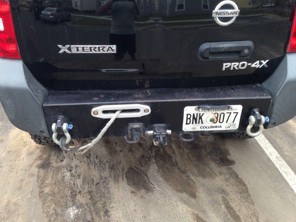

Nice ride man! Do you have anymore pics/info of the rear winch setup? Really liking the way that came out. Good work.
1,743 Posts
Discussion Starter · #11 ·
This only a little cleaner wiring. It runs on a wireless remote so I dont need to mess with another controller and it keeps the solenoids out of the elements. It has definitely held up so far!

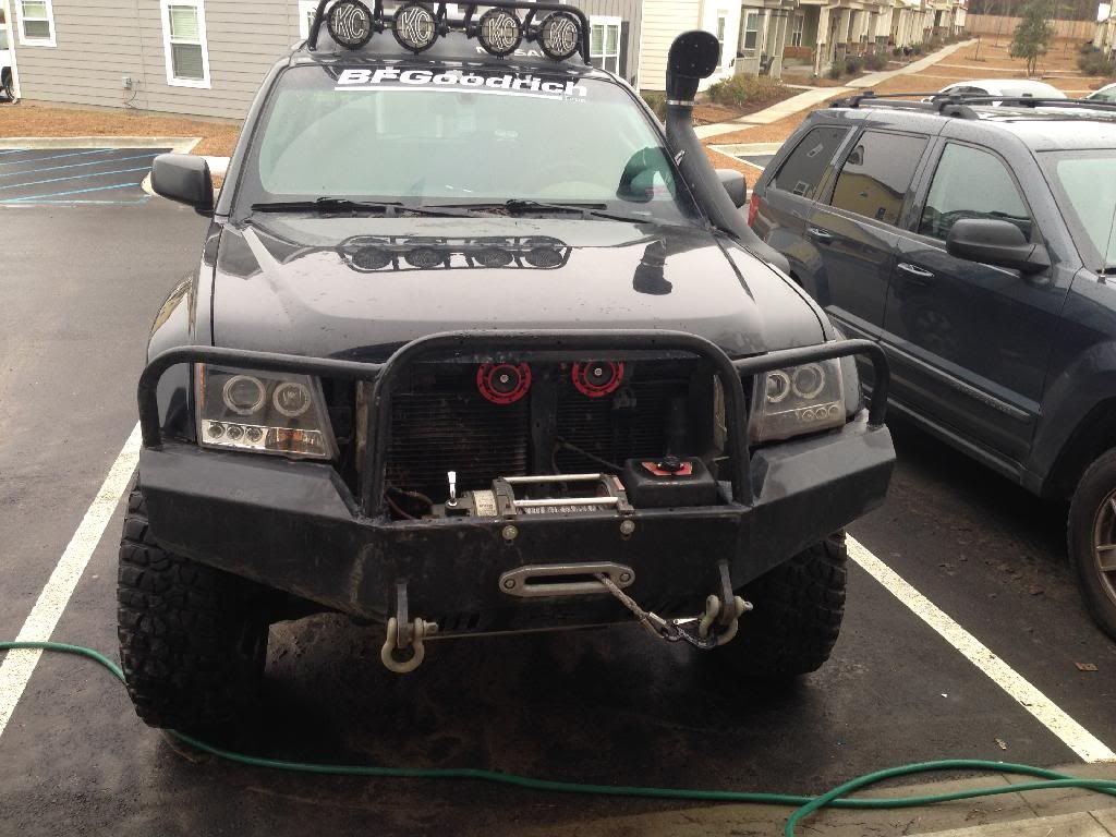

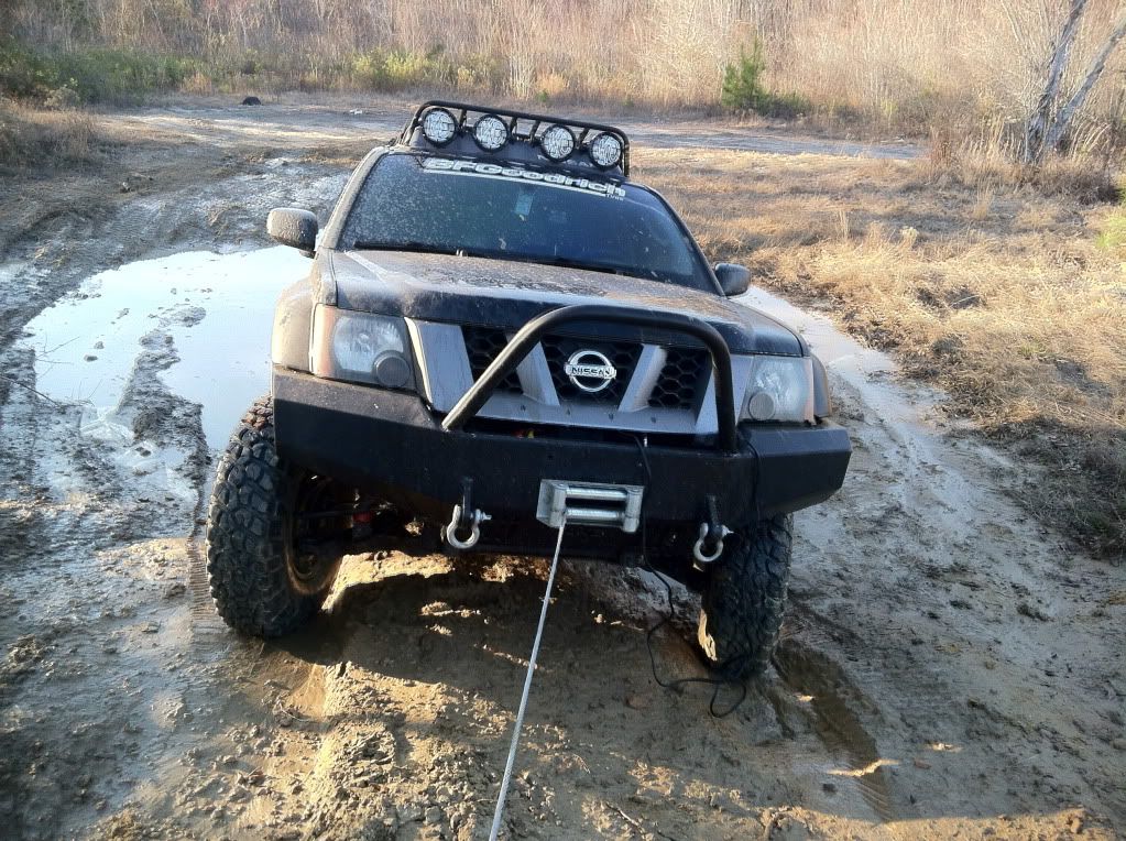

For your TAG Stinger Bumper did you cut off the stinger bar and make your own custom piping?
Yeah I cut it off. There is actually a member on here that has a tag bumper and didnt like his tubes so he cut them off. A year later i sent him a pm and it turns out he still had them laying around so we agreed on a deal and here it is.
before:
testing fit, it still has the line x on it:
done:

Just a note though: your hawse is at the top and your winch is wound at the bottom. This will cause extra wear on that synthetic line as it's always rubbing hard on the hawse under load, and possibly even that cross brace bar on the bumper. This is an easy fix, though. You can either flip the winch over, or you can let all the line out and wind it in the top side, then just switch your two power cables and out on the remote will still be out, and in will still be in, once you swap the power cables from each solenoid.
I had no idea this was such an elite group haha. That winch actually kind of fell in my lap when a buddy gave it to me for helping him build a bumper for his f150. I decided to whip up a mount and cut a hole in the rear bumper and here we are.
Also the picture is a bit misleading but the line actually spools out on top of the winch.
