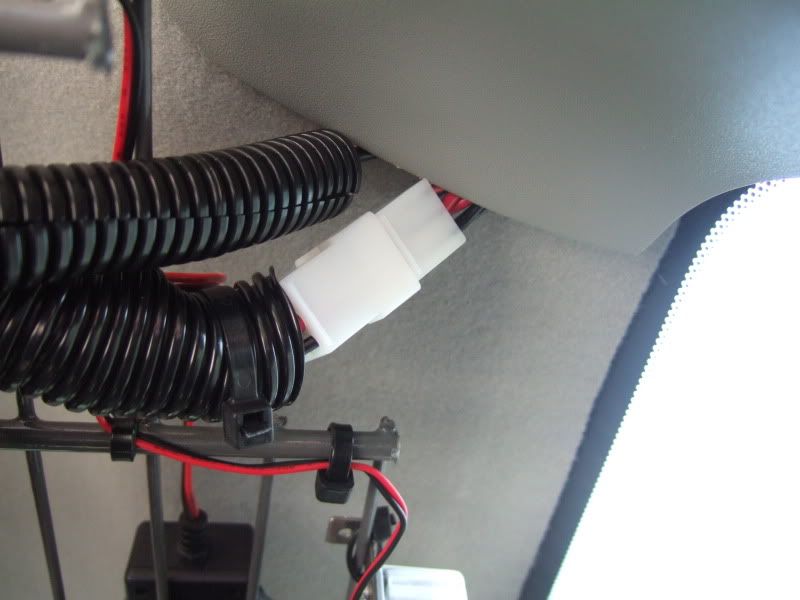

Interior wiring begins
Quick disconnect plug for cargo panel

Lobo shelf with power inverter rear warning lights and cargo lights.
Quick disconnect plug for lobo shelf removal if needed.
