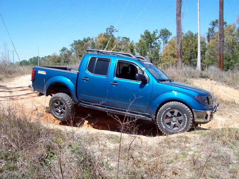

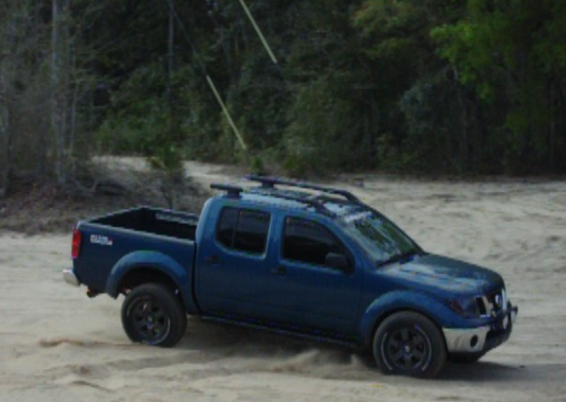

Here's pics of my Titan swap. I've got stock Titan UCA's and LCA's, Titan HD shocks, stock Nismo springs, PRG 2" spacer, PRG tie-rod extensions, Energy suspension bumpstops... I think thats all of it right now.
STOCK FULL DROOP ON PASS. SIDE, TITAN SWAP ON DRIVERS SIDE:
TIRES ON, JACKED UP ABOUT 8":
GLAMOUR SHOTS IN FRONT OF NISSAN PLANT:
SUSPENSION TESTING:

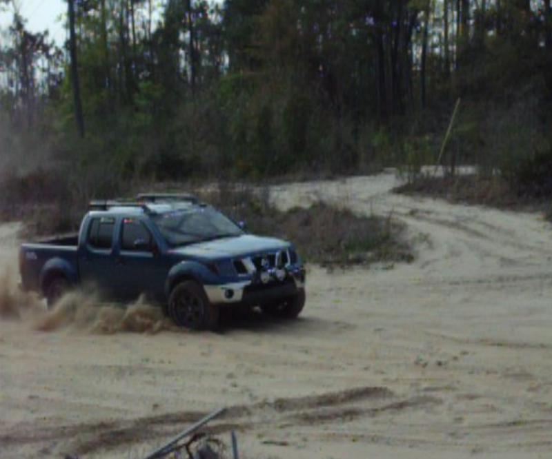

Apologies, but I've got an off-topic question for BWarren (feel free to move, reply by PM, etc ... as needed to keep things on-track): Can you give some info on that light bar of yours? I'm thinking of basic stuff like: cost, manufacturer, ease of install (though it looks pretty straight forward) ... Thanks!

I don't know how often BWarren makes it over here, but I have some info on his light bar. Check out this thread and this thread on frontierboard.com . Ive asked him about the mounting points for the Xterra and he said he would check when he gets a chance. If ive missed any info I'm sure he will chime in.

I've gotta remember to check an Xterra at the dealer. I checked Pathfinders, and they will fit, but the '08s are different with the new front end. Even if it doesnt bolt up to the bumper, you can bolt it to the radiator support brackets behind the bumper. This is true on the Frontiers anyway.

Oh, and check out WhiteRhinoFab.com to see the bar and the shop that made it for me.
Here's another close up of it I took:

Just because I'm dumb....what did you gain from doing the swap?
376 Posts
Discussion Starter #16
Tons of wheel travel, better turning radius, meaner looking... Did I mention extra wheel travel? :D See first picture!

If you are 4wd, it takes a bit more work. Only difference would be swapping out the cv's for extended length axles. Also, you can't get as much lift out of the 4wd setups. With a 2wd Titan swap, its possible to get over 5" of suspension lift BEFORE adding spindles. Thats a possible 9" of pure suspension lift you can get!
376 Posts
Discussion Starter #20
A guy by the name of BigRiver on frontier forums has ~5.5" on his Titan swap using PRG UCA's, Titan LCA's, Titan Bilstein 5100 adjustable shocks, and a spacer. Just add a spindle lift and you've got your 9+ inches.
